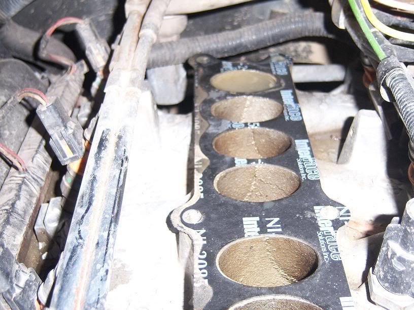

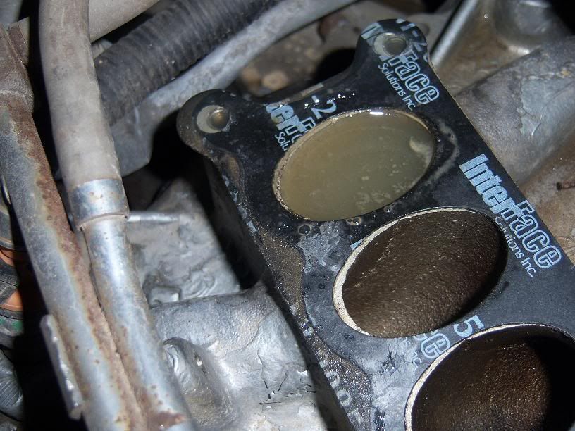

I took the upper plenum and most the stuff of the front today and found this....
Here lemmie zoom in for ya
Wow.. guess that hole was a lot deeper than you thought. Sucks. I guess you'll be doin what I was yesterday.. shortly.....
