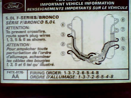

Did you check the firing order of the plug wires yet?

Here's the firing order
It's just a matter of elimination until you get there Bruce , it can be very frustrating at times lol. I'd start at the beginning and check all the basics like spark plugs , leads ,cap ,rotor - these could be breaking down under load and it wouldn't be a bad thing to change them anyway. Also the coil maybe getting weak as well. It pays to check ground connections especially.
