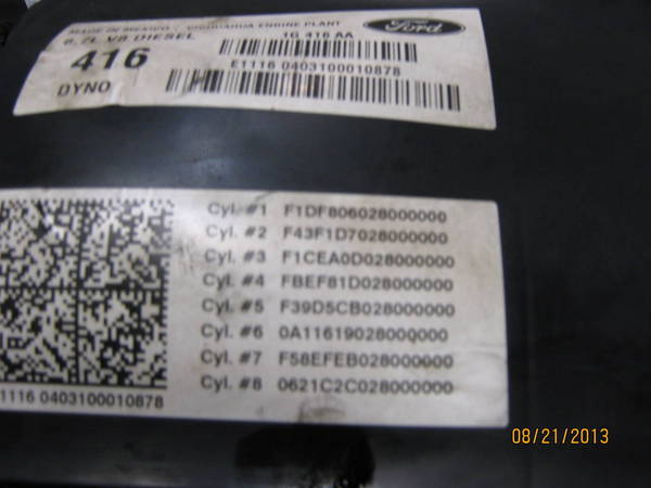

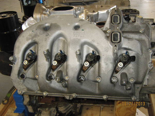

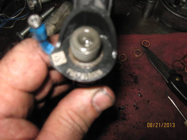

You have to be careful about using the right injectors in the right cylinders, right? Aren't they super calibrated and uniquely identified by the computer?
Each has its own flow rate. This is programmed into the PCM. If you replace one injector, you have to program it for that particular cylinder.
