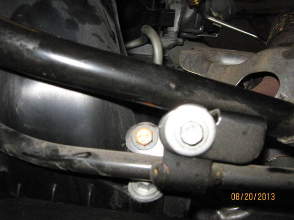

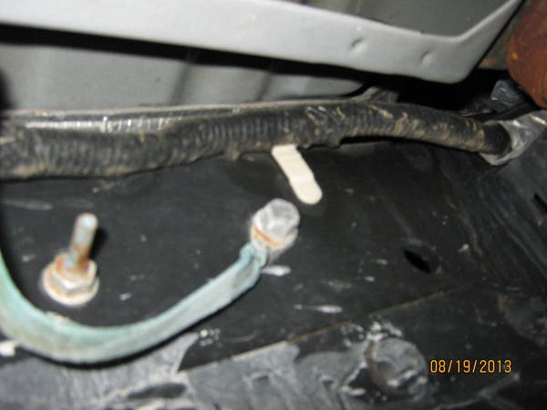

pass frame ground strap

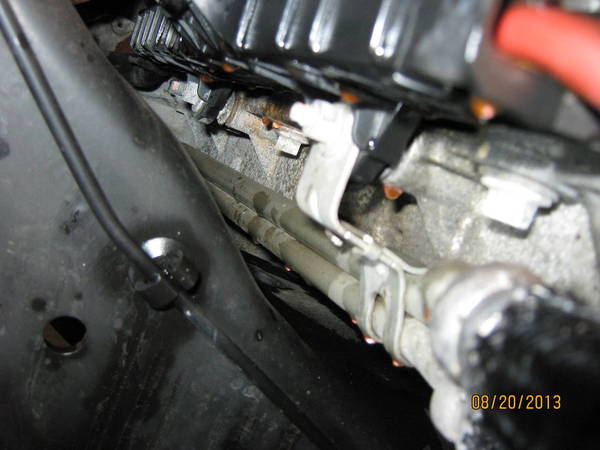

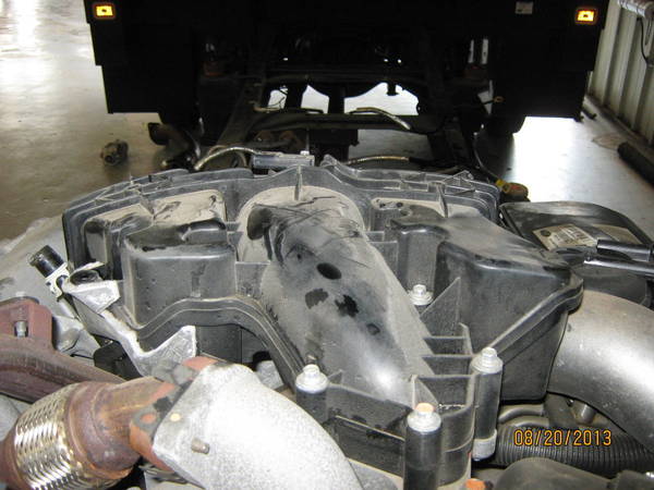

remove body bolts, and lift the body (same as 6.4). Made easier by getting to the top of the bolts, and use a torch to heat up and melt the locktite.

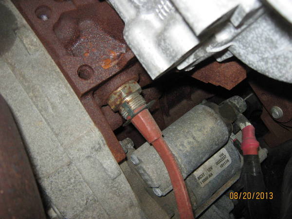

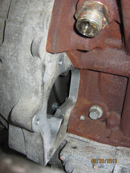

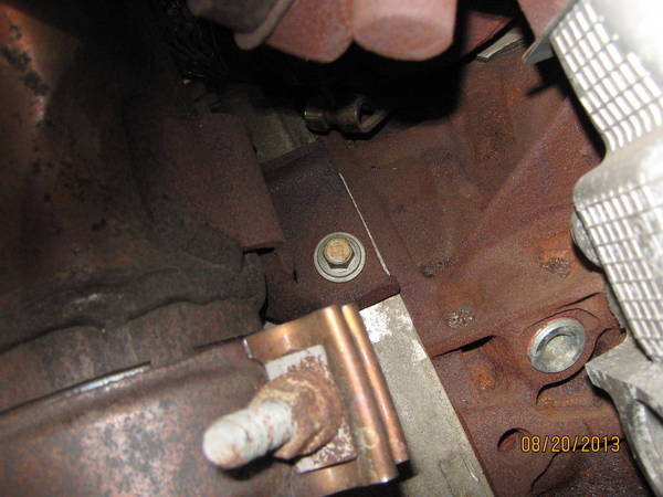

torque converter bolts through the starter hole
these are "JEESUS BOLTS" when putting them back in, jeesus dont drop them. No access hole to get them out.
