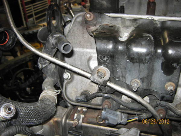

nut for fuel injection return bracket
Jun 22, 2012 Moderator #81 blacksnapon Moderator Staff member 9,461 301 waynesville,mo. nut for fuel injection return bracket

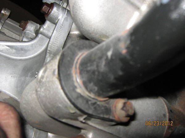

Jun 22, 2012 Moderator #83 blacksnapon Moderator Staff member 9,461 301 waynesville,mo. driver side heater pipe Last edited: Jun 22, 2012

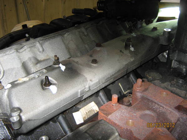

Jun 22, 2012 Moderator #84 blacksnapon Moderator Staff member 9,461 301 waynesville,mo. intake manifold bolts remove intake manifold Last edited: Jun 22, 2012

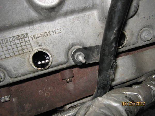

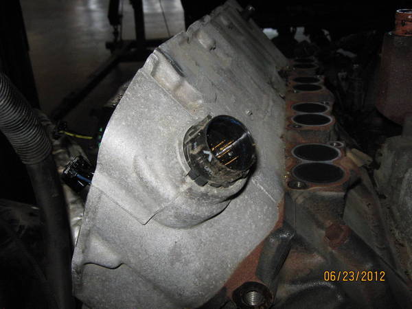

Jun 22, 2012 Moderator #85 blacksnapon Moderator Staff member 9,461 301 waynesville,mo. oil dipstick bolt

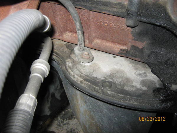

Jun 22, 2012 Moderator #86 blacksnapon Moderator Staff member 9,461 301 waynesville,mo. oil dipstick bottom bolt, then remove tube

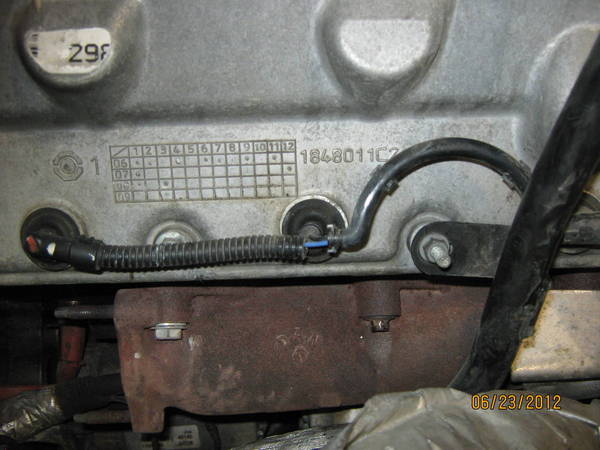

Jun 22, 2012 Moderator #87 blacksnapon Moderator Staff member 9,461 301 waynesville,mo. glow plug harnesses

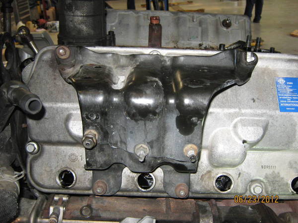

Jun 22, 2012 Moderator #88 blacksnapon Moderator Staff member 9,461 301 waynesville,mo. turbo support bracket

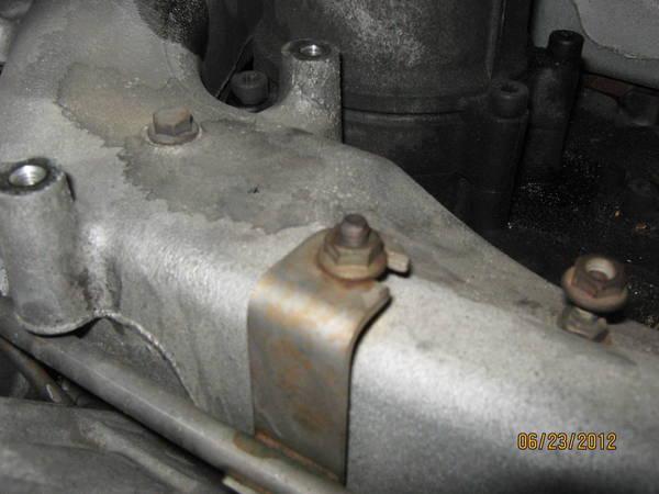

Jun 22, 2012 Moderator #89 blacksnapon Moderator Staff member 9,461 301 waynesville,mo. fuel line retainer bolt

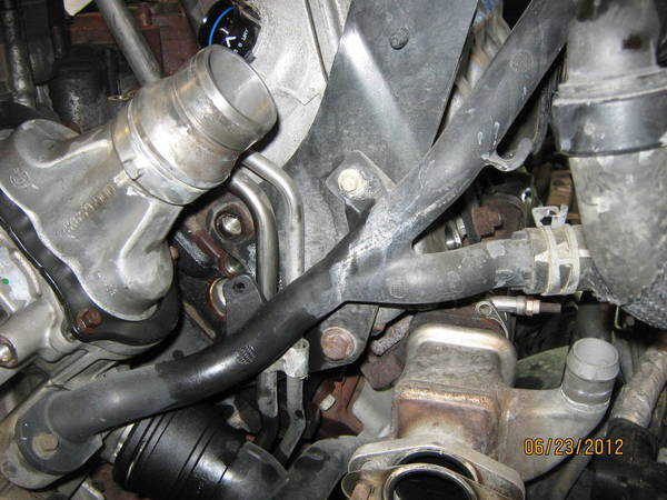

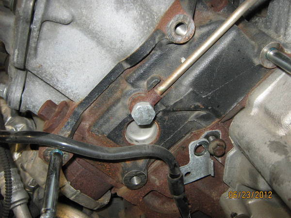

Jun 22, 2012 Moderator #90 blacksnapon Moderator Staff member 9,461 301 waynesville,mo. egr cooler pipe

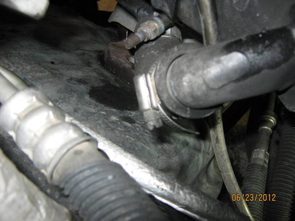

Jun 22, 2012 Moderator #91 blacksnapon Moderator Staff member 9,461 301 waynesville,mo. clamp on egr cooler hose (then completely remove oil dipstick

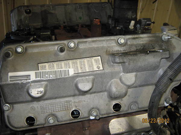

Jun 22, 2012 Moderator #93 blacksnapon Moderator Staff member 9,461 301 waynesville,mo. remove valve covers

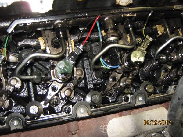

Jun 22, 2012 Moderator #94 blacksnapon Moderator Staff member 9,461 301 waynesville,mo. remove frp sensor/injector connectors Special tool to remove injector connectors Last edited: Jul 26, 2012
Jun 22, 2012 Moderator #95 blacksnapon Moderator Staff member 9,461 301 waynesville,mo. remove connectors then remove harnesses
Jun 22, 2012 Moderator #96 blacksnapon Moderator Staff member 9,461 301 waynesville,mo. remove injector lines (one time use only)

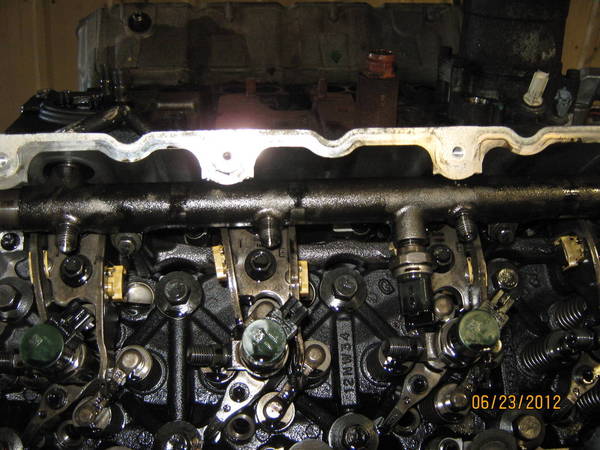

Jun 22, 2012 Moderator #97 blacksnapon Moderator Staff member 9,461 301 waynesville,mo. remove fuel rails

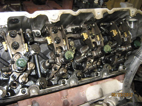

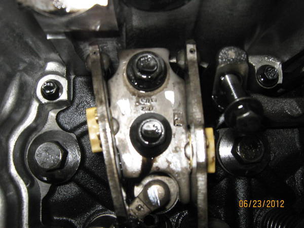

Jun 22, 2012 Moderator #98 blacksnapon Moderator Staff member 9,461 301 waynesville,mo. mark position of rocker arms then remove

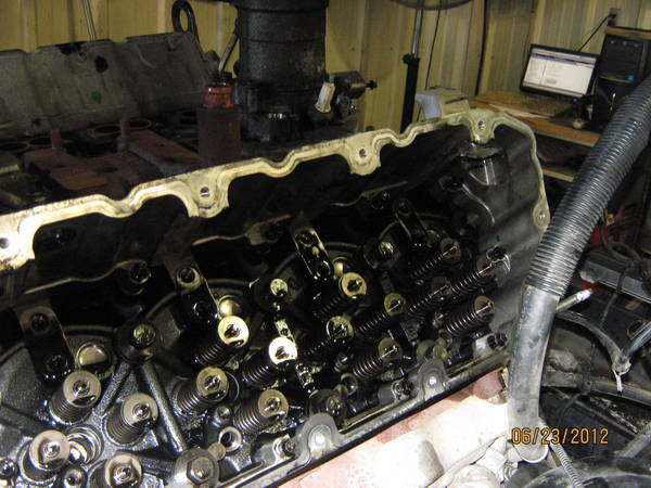

Jun 22, 2012 Moderator #99 blacksnapon Moderator Staff member 9,461 301 waynesville,mo. remove rocker bridges, pushrods, then "rocker box"

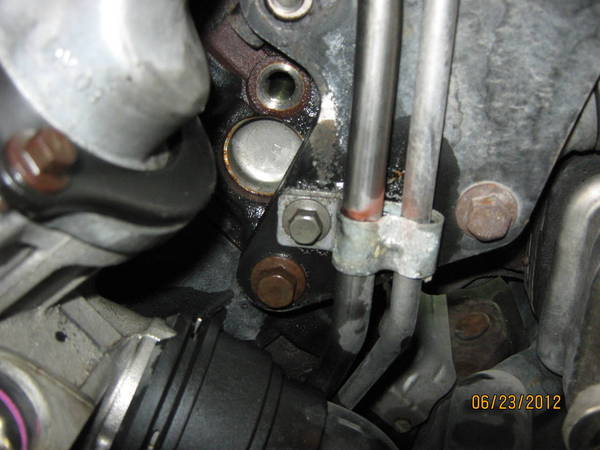

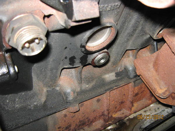

Jun 22, 2012 Moderator #100 blacksnapon Moderator Staff member 9,461 301 waynesville,mo. remove starter, block heater cord to get to block drain
