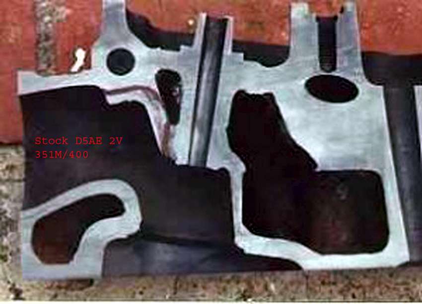

I did... what gets me is the 400 head.. nobody seems to care they are choked to death... put a C head on a 400 and let it breathe those extra cubes... 4V would work even better than the 2V on a 400 just an extra cost of the adapters.. but you would have more intake choices.. Guess I have spent to much time porting 302 351W heads, when I came upon the D5 head I couldn't believe how bad the exhaust port was compared to any of the C heads...

Ya I know 2V c heads don't need adapters.. and yes I know all about he 4v heads, they are to completely different animals .... did you look at the pictures I posted? guess am I the only one here that has had a 400 head on the bench and seen the exhaust port in them.. yes it the same basic head and it will bolt to all the 335 series... I didn't tell him to go buy a set of 4V but I did agree with someone that they would work awesome on a 400... the OP said he could get a set of 2V C heads and I said get them, they are way better than the 400 D5 head he has and to not spend a penny on the D5's... But everyone says the 2V C heads wouldn't be worth it and I bet not one of them has ever swapped a D5 head for a D1 like I did .. the difference was very noticeable.

The top of the guide boss runs flat across the port... what you see for an opening at the short turn is all you get..
