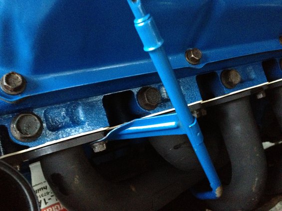

Did you paint the engine, Scott? Looks nice.

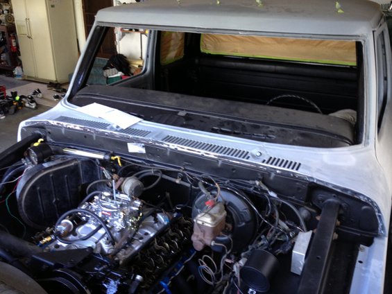

Yes, I used 3" roloc disc to clean all the crap/rust scale off the block and then sprayed it with brake clean to get off any residue. The valve covers and oil pan I stripped to bare metal then primed and painted. Most of the brackets got a coat of bedliner after a soak in the electrolysis bucket.
Pretty much the top end is done. I need to set the firing order on it now. I primed the oiling system, installed the valve covers, set the dizzy in, mounted the A/C compressor, installed the spark plugs, got both headers on and tightened. Next up is to install the A/C box again, get the power booster mounted, figure out whether to paint or use bedliner on the M/C, get the steering shaft mounted and then reinstall the front clip. I want that all done before I even attempt to start it.

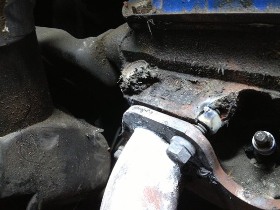

From this:
To this:
So much nicer looking than the nut I welded on.

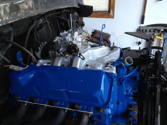

Morning wood. Some wiring, anti-freeze and some vacuum hoses and it is ready to go.

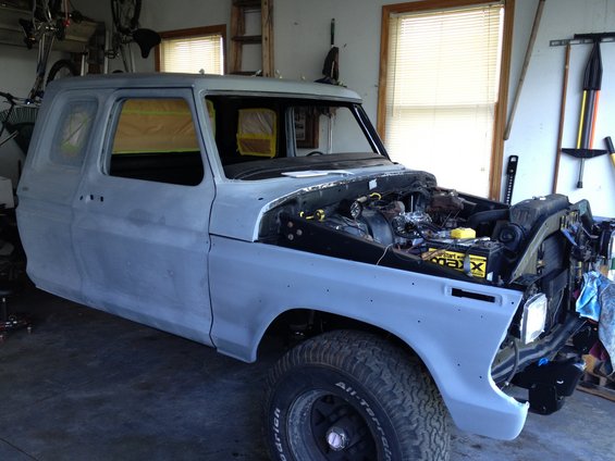

Well it has been nice having a few days off. Hotter than hell but I pushed through. Done for the day, time to go watch some high school football.

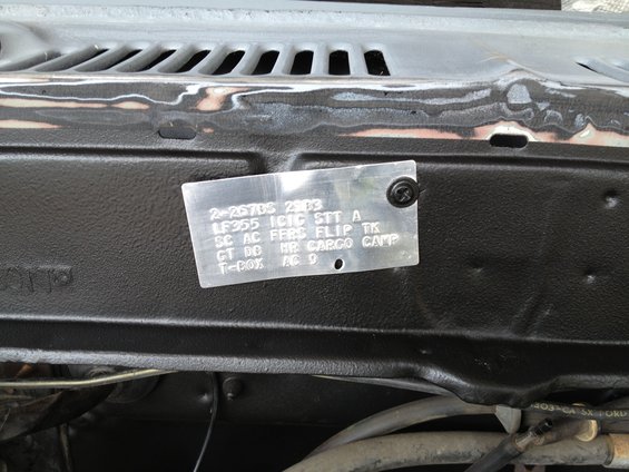

I also decided to bedliner the upper cowl. This will make it easier for me to finish with the engine compartment reassembly. I made the cut line where the rubber hood strip seal goes.

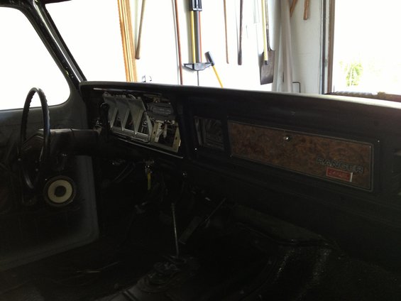

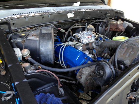

Thanks Duncan I know you read my push rod thread but here is a little update since I'm waiting on a new set from Summit. Couldn't work on the motor so I put the front end back together to make final cab and core support adjustments. I also installed the dash.
I thought I was all done with the motor. Finished it all up and finally got it running. After starting the motor it wasn't running right, had a pop to it. After checking it out the pushrods are to short. In the meantime I assembled the dash, put the front clip on to adjust the cab and core support.
Once the pushrods are here and it is up and running properly I am concentrating on getting it painted.
The blue dash lights look cool.
885
53
And bright! They adjust all the way down though with the dimmer switch.
Nice...did you change that heater control/radio bracket or was it unmolested?
885
53
It was just net, I was able to end it back to normal. The only thing he broke were the lower mount tabs for the heater control. I had a spare one of those I used.
