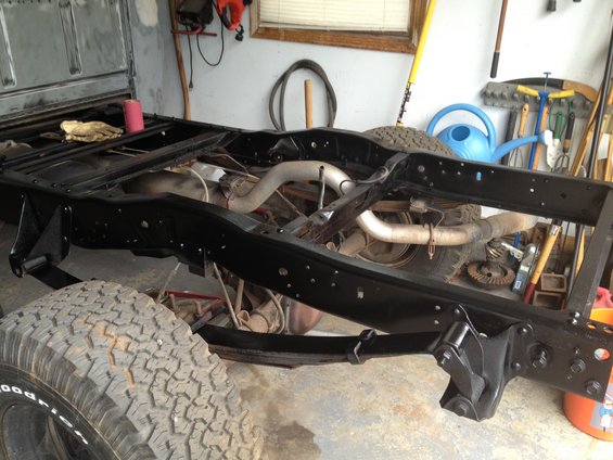

I did start sanding the rear frame, I plan on undercoating that. I haven't pulled the cab, not sure if I'm going to. I'd like to have the frame sandblasted but really wasn't planning on going that far with this build. More than likely it will just be cleaned and undercoated underneath the cab.

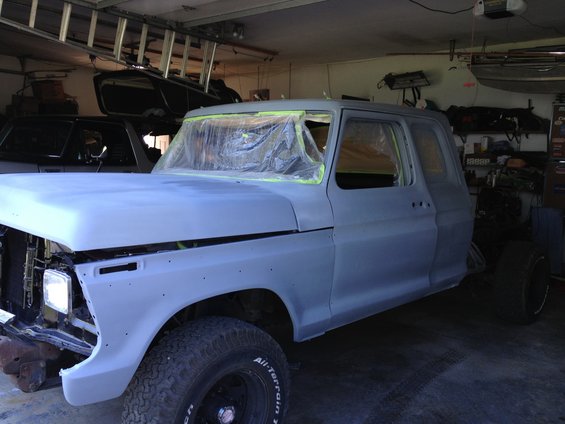

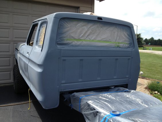

Back at it! Between the rain today it dried up enough for me to get the back of the cab primered. I have one more dent in the hood to fix and it is ready for paint! Hopefully funding will allow me to get this painted before summer is up. As much as I'd like to get it to a shop with a booth if the funds aren't there I'm probably going to do it myself.

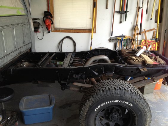

I ditched the idea of undercoating the frame and decided to go with black paint.I first sprayed on some rust converter then primer and then the paint. Turned out pretty good. I also pulled the rear tank, cleaned it and painted that to. I need to pull the aux tank and clean that one next.
I also opted to remove the overload springs and frame brackets. They will be of no use with a lift on it.

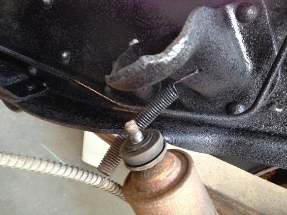

Think that shock will work? Fully extended, suspension popped once I cut the head off. This was with the shock fully extended.

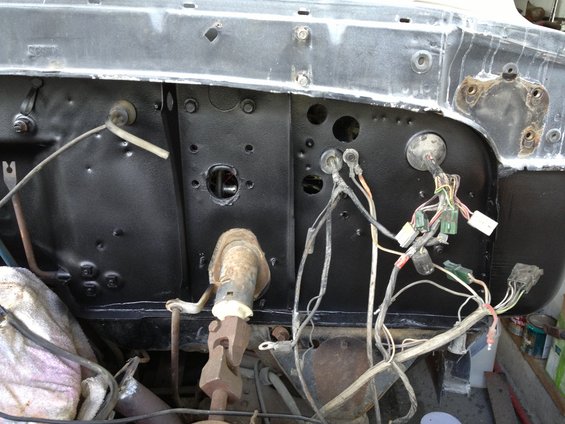

Buck tag on the firewall. Did a little cleaning on it today. Went from this:
To this:

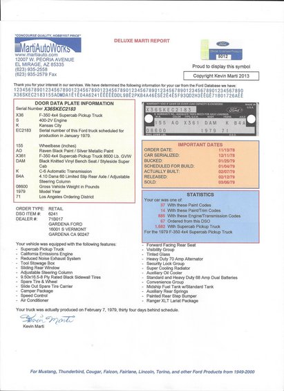

Now I just need to figure out how to decipher some of the codes, most I know.

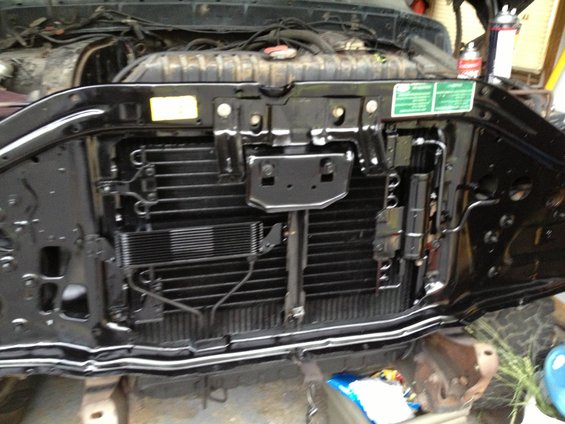

Also sanded the core support and got some primer and paint on it.
Before:
After:
Tried to save the radiator sticker and the A/C sticker. The radiator sticker peeled up with the tape.

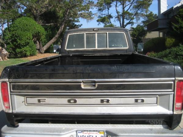

I also found online a couple of pictures of it before the HACK got his hands on it. Yes that is white and not the original color. His grandpa had the silver redone in white.
And why the bed was in such great shape.
Evidence of the OE color. This gate took some abuse by the fawker and his camo paint. Those panels had to be in superb condition! :banghead

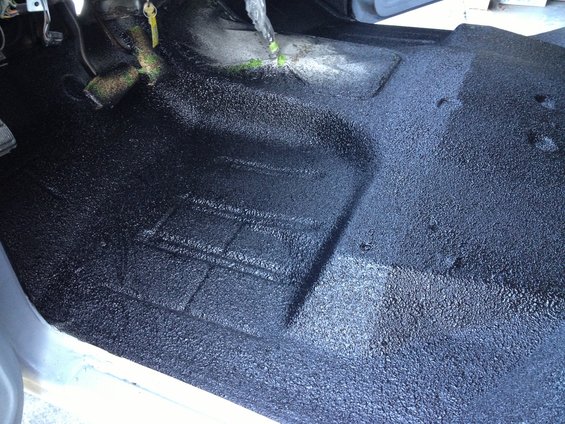

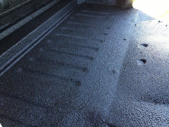

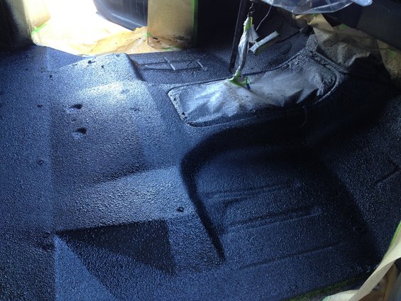

More work. Als liner on the interior floor sprayed on with 25PSI. Pieces of tape covered all of the seat mounting holes to keep the liner from getting in there.

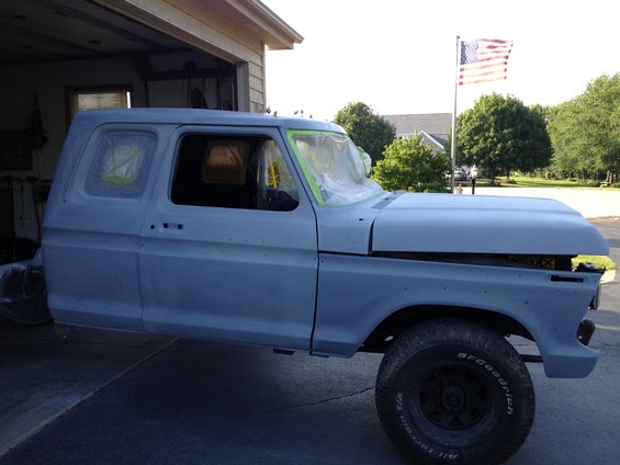

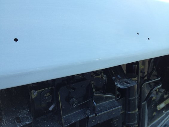

And a ton more sanding and priming. I believe I have the cab and front end ready for paint. I still have to sand the bed, haven't touched that yet other than sprayed the primer on it but I think that should go pretty quick.
Hood repair where I replaced the metal.

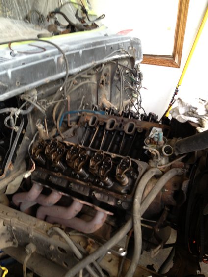

Decided to tear into the motor before the paint. I also snagged a brand new Edelbrock Performer intake on ebay yesterday for 175 shipped. looking for cam, lifters, timing chain set and a complete gasket set. I'm also going to junk these heads and get the other set into the shop for a valve job.

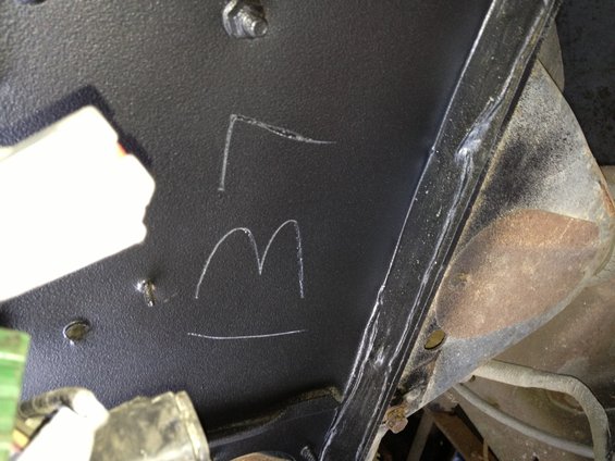

Wish I knew someone that worked the assembly line, curious to know what the 137 meant.
885
53
I don't see how it could be a final inspector number. It would of been awful hard for him to scratch that on there with the inner fenderwell and plastic liner in place.
I called my friend, his memory is failing him too.
He seems to think the number indicated that that particular truck was going to be bought by a Ford employee. As it went down the line, the workers would take an extra second to make sure everything was perfect.
885
53
If that is true Mark I've got one hell of a special Supercab!
Mine doesn't have a number.
I'm going to call another friend that works parts dept. and worked lincoln parts back in the 70's.
He ordered a '79 F 150 that took 6 months to get. so I think he might know. That truck got stolen at about 6 months old and was never seen again.

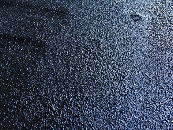

I'm really liking this Dupli Color bedliner spray. I think it will last for a long time and add a lot of protection.
I tried for all practical purposes to replicate the 137.
