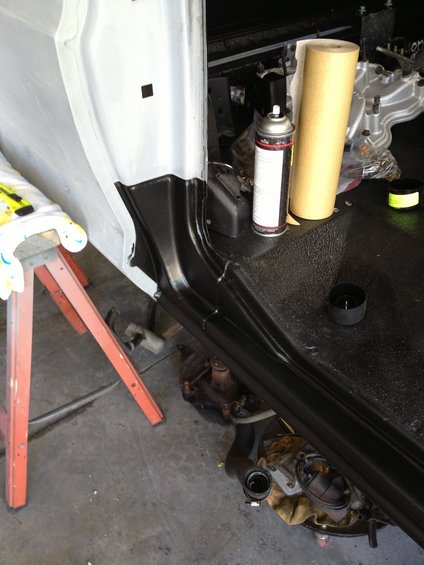

Any reason you chose to go with the duplicor instead of paint??? Or just insulation purposes??? Looks like it belongs there without too much texture. You worried about it fading any???

I went with the DC for a lot of reasons. One it is a bedliner, it lays on thicker than paint, prep work is a lot less, cost is a lot less and it is more resilient to scratches. It is paintable and I'm going to do a test paint on the power steering bracket i bedlined before I try it on the firewall. If it looks good i will paint the firewall black. Fading never really entered my mind but I don't think it will because it won't be exposed to the elements every day.
I'm really interested in seeing how the painted bedliner turns out, I think that would bring it all together really well.

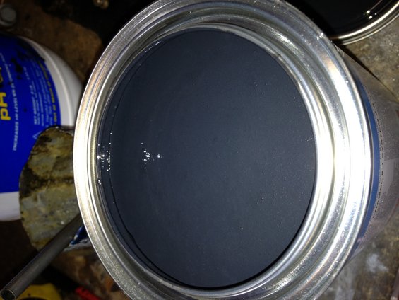

On another note I got this from UPS today. It is the original black metallic dash color. Guess I know what will be painted next.
TCP Global is where I got it from, code is 32586.

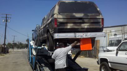

I had to go over to that other place to figure out how long I've owned this truck. It looks like it left Ca on 08-13-2012 and arrived here on 09-06-2012. Picture below of it loaded up leaving Cali.
And for the future my purchase thread. http://www.ford-trucks.com/forums/1...er-special-lariat-long-bed-side-tool-box.html I don't remember where he started but I was at 2K for it plus shipping then he hit me for another 500 because someone else was going to give him 2500 for it. Aside from the hassle of buying it from this dick and getting screwed around on the title I'm glad I went through with it.

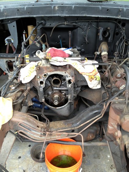

To cold for paint today..... So I ripped apart the rest of the motor. Time to order up some parts. I'm about one step away from lifting the cab off the frame to. Not sure I want to get that far with it though..... decisions, decisions.
My vote is take the cab off. Simply because I'm the OCD freak I am, it'd allow me to clean everything. :D
When you do that, it leads to all kinds of extra work which from what I have seen, leads to abuse from others because it takes too long.
:D
Seeing your truck finished is my retirement gift to myself... considering I won't retire for another 50 years; I'm sure it'll be done... mostly. smilietease
There is no middle finger smilie it seems....smilietease :wavey:
We need to fix that! :rofl:
Take the cab off...a couple extra days of cleaning and painting will be worth it. You're this close now...might as well. It would eat me alive knowing going to the extent if work you do/have already done and know I left something untouched.
This is kinda what I'm thinking, BUT Duncan has a point. Apart from doing a complete frame off nut and bolt restoration, it could just lead to, "Well, now that I have the cab off, I can do this..."

That is one reason I don't want to pull the cab. This would turn into another 2 year project. I'd also have to build some custom horses to set the cab on. Other than the top side of the frame rails there wont be much I don't detail.
It is close to being off though.

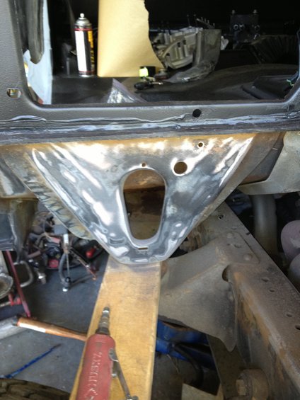

Sanding on the frame rails.
I decided to go full bedliner on the door jamb as well.

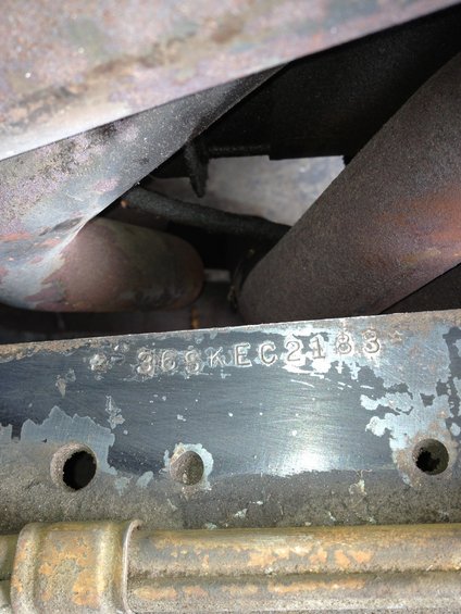

The all important matching VIN. Looks like someone was lazy and forgot an X.:headbang:

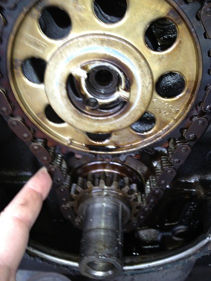

Still had the original phenolic cam gear with just a little slop.

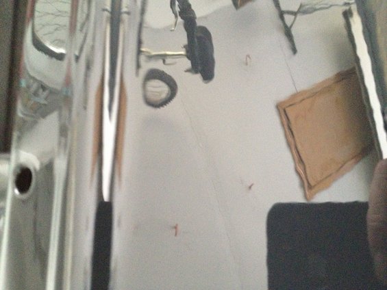

Got a little paint work done today. It was in the mid 70's and no wind. Ended up with a few bugs but I just buried them deeper in the paint. Unfortunately it is a single stage paint so no wetsanding. Gloss is great but I don't think the color is spot on. Going to have to live with it.
Looks good!
Who says you can't sand single stage?
