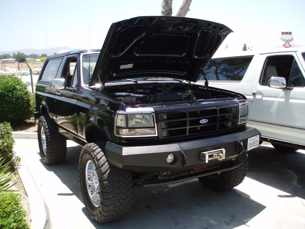

Different year, but this is a pretty slick set up:
Yeah I really like that bumper...and would loooooooove to throw that bumper on Thunder, but I really haven't found an aftermarket bumper that can handle any sort of abuse I like for dentsides.
Ben I would hope that you wouldn't rely on Rhino liner to protect your bumper from the winch cable... You'd need a fairlead (preferably a 'roller' like on the black bronco above) in order to protect both the bumper and the cable.
Definitely not Chris...if I could get to fit behind it. I was just saying the cable still has to come out and can't always get it on a flat plane...so my concern with that would then be cutting/splicing the cable through the slot yadda yadda yadda. It's a moot point anyway, I figured I'd go Ed's route.
