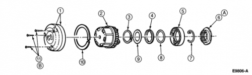

Mike that sounds like a really shady setup... If the previous owner converted from autos to warn manuals then you should DEFINITELY have a spindle nut conversion kit. The conversion kit just includes 2 spindle nuts (the 4 pronged spindle nut tool drives these) and a lockring that is sandwiched between them. The spindle nuts replace the 'star nut' and half-moon pin that you've got in there now, and also deletes the 3-piece thrust washer set. Here's a diagram of what I'm talking about:
Everything from 'wheel retainer' to 'retaining ring' gets removed and thrown out, and the hublock assembly gets replaced with the manual assembly of course. If you have ANY of those parts in your hubs then you are not setup correctly. All of those parts should be deleted and replaced with this spindle nut kit:

Well the superduty might be different. Go on Warn's website and pull up the Warn manual hubs for your truck like you're going to buy them. And on that page it will say YOU MUST INSTALL THE SPINDLE NUT CONVERSION KIT with this hub set.
