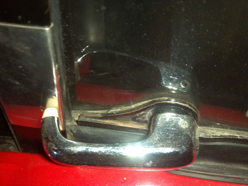

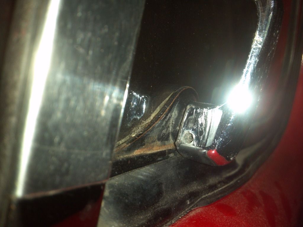

I couldn't find a d*** thing.....I see two tiny holes with what looks like little screws (without heads) in them, but nothing that can twist those.

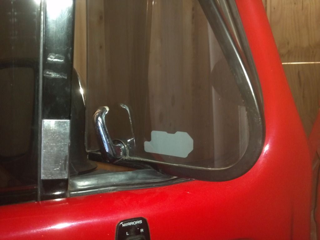

I don't think this has anything to do with the frame....that little latch is loose and the one on the passenger side is super tight, so no issues there. It's because I use it more, thus it started to loosen a little.
I did the coin trick on my one truck for a little while. I finally made a plate and attachedit where you wedged the coin.

There is a little pin in the hole that needs to be punch out. I bought a small punch and was able to hammer it out carefully and then grab it with a small needle nose. Then you can put a new latch on and tap the pin back in. There are two different latches and I originally bought an upgrade with the lock button on it, but the pin holes would not line up, so I bought the non-locking one and it went on just fine. I get more noise through the driver side than on the passenger side and I can't tighten the window up any more than it is. But a new latch would help some. I had a lot of noise before I installed a new latch. Looking at your latch though, it looks to be in good shape. Usually the "white" end gets worn down over time which causes the vent to not be as tight and why the coin trick works. I don't know, I still get drips of water in the truck when I wash it through most of my weather stripping and rubber seals around the door and everything is new and I can't see where I would have installed anything wrong. I just think that the design of these old trucks aren't perfect and not meant to be quiet. It would be nice. I know there are one window kits out there for chevy and in time the company that makes them are supposed to make ones for our Gen. 6s, but that has been talked about for the past few years and haven't seen anything yet. I do like the wings though.
You gave the answer before I asked the question. Does the white end wear down causing a loose fit? It always looked like nylon to me, and I could see that wearing over time. I guess this is the case! Thanks, Buck.
