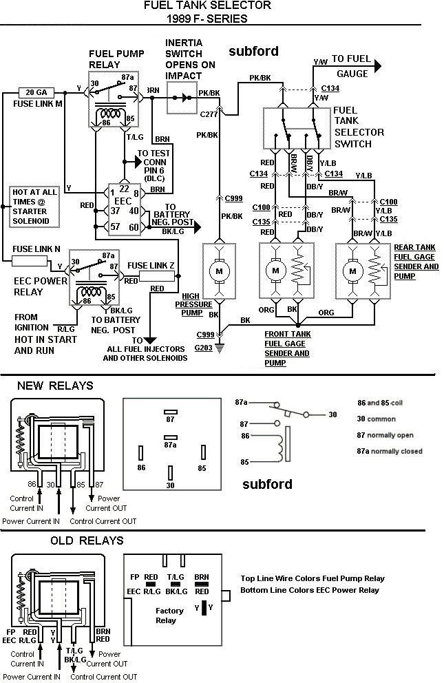

This would be a good time to do the conversion over to Bosch Relays like the Fords in the 90's have.
Do you need a diagram?
yeah do you have a diagram? might be helpful
Glad you found your problem.![]()
I hope this helps:yeah do you have a diagram? might be helpful
I made it, you will not see it any place else but here.oh man! thanks a lot! that is definately better then the alldata ones..... can't stand "almost data" we have it at work and im not a fan of it. where is that diagram from anyway?
