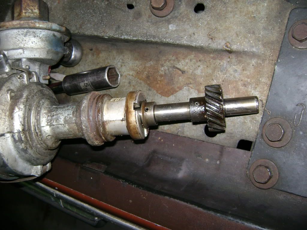

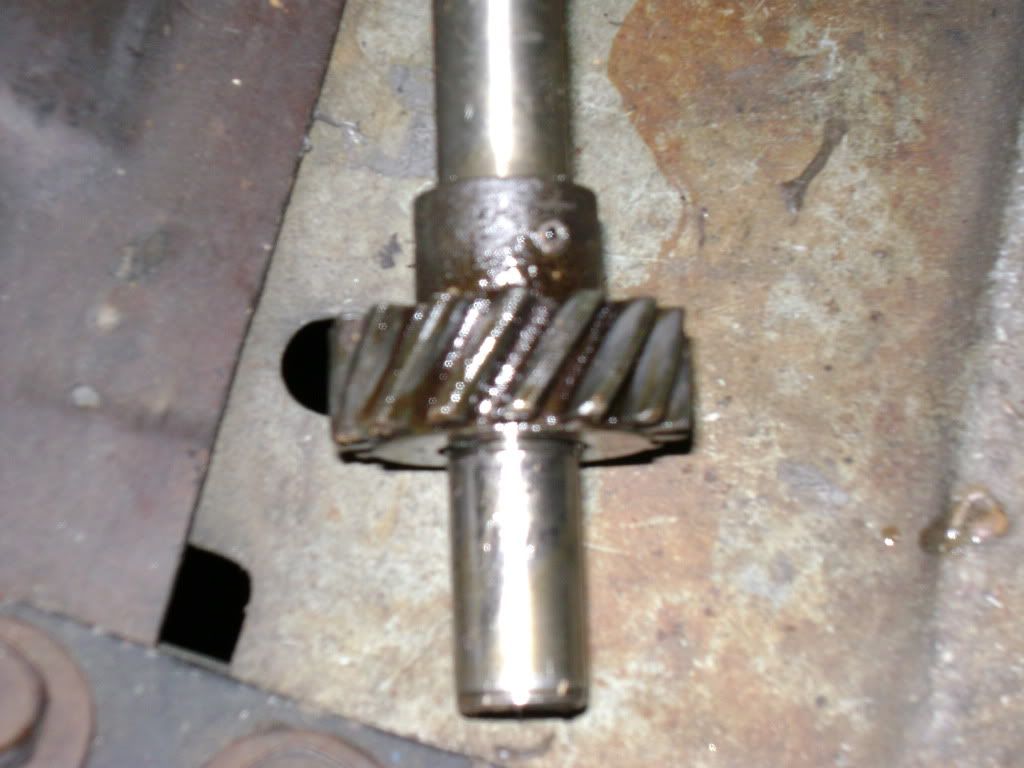

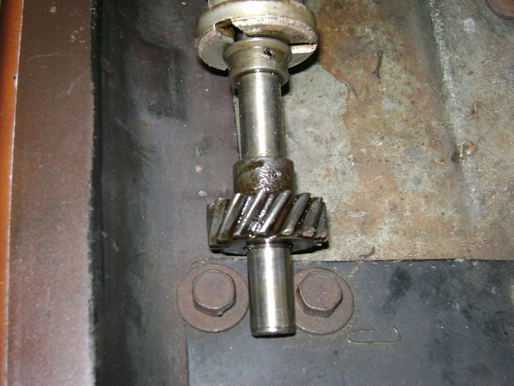

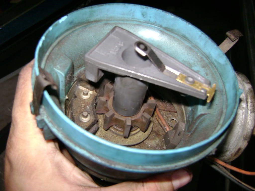

Pulled the distributor out, not any visible damage that I can make out. I'll post pics later tonight in case I overlooked something.
TDC lined up just fine and Here's the distributor...everything looks fine to me, unless I'm missing something:

Did you remove the pin to verify ?
Nope...sure didn't. I suppose that woulda been helpful, huh? Does it just tap out with a dowel or something?
smokey
Hitech hillbilly
Yep they just tap out with a small punch.
Many times they look fine then when you go to tap it out, it will not budge because it has turned on the shaft and the holes are not lined up.
When you tap it out you don't have to completely remove it just a little over half way to verify that it is not sheared off.
When replacing the pin a bit of locktite or nail polish to secure the pin is a good idea.
