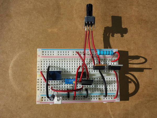

Well, after the last little oopsie and setback, things are looking up. Unit is up and running, but there is still work left to be done; range of adjustment for the time to fade-to-off isn't quite satisfactory.

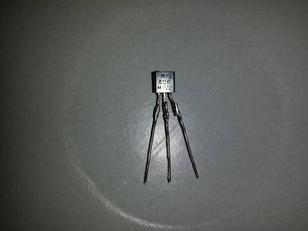

However, after investing time into reading about a couple of the components in the proto build and comparing them against others +bench test time measuring circuit parameters and studying the effect of them and varying them, it is thought that swapping this salvaged transistor might either solve the concern or at least validate my thoughts and set me in the right direction, namely, find the right transistor. Almost embarrassed to post a pic of this part I salvaged, but hey, ever since Radio Shack blew it with their business model back in the early 80's everything a guy needs for parts is now 5-7 days out or $30 overnight. :(

As for parts here, I'm not aware of any supplier of significance. Maybe a very watered down selection of select parts like resistors, and the 'Shack has a very limited selection of parts. Because of this, when some electrical device here goes TU and if the components aren't SMT, I now keep the boards as a potential parts source. FWIW, that transistor came off the board inside a Ford (Gentex) auto dim/auto lights on at dark RV mirror.
