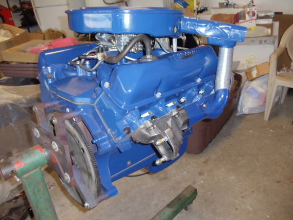

On the power train I bounced back and forth FE vs. 460. It originally had a 360 that never really had a lot of power, but it was as dependable as the day is long. I decided to bump the 360 up to 390 specs when I rebuild it, I already have the crank and rods. I'm going to do a mild build up, nothing radical, just a little more power. I'm keeping the C6, just a good rebuild.
I'll keep you guys updated on my progress.
I think the bump from 360 to 390, and retaining the factory look instead of going 460 will make you extremely happy.
Wow, I can't believe it's been a year since I've posted any updates here on the Pumpkin Project.:hammer:
The chassis is done, that was Phase 1, the powertrain, with the exception of a few details (like installing the engine and transmission) is done, that's Phase 2.

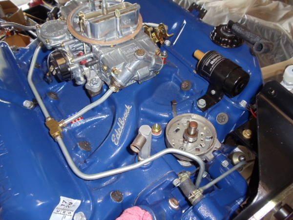

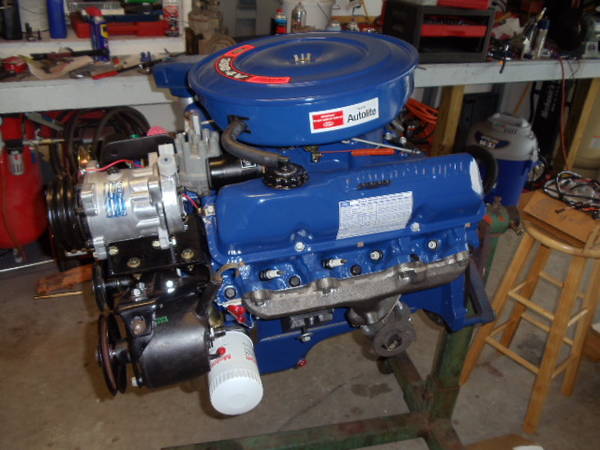

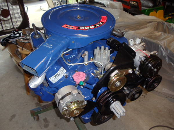

That's pretty much it. I bumped the engine up to a 390 when I rebuilt it. The block I used cleaned up with a +.030" bore, new cam bearings, the deck and mains were fine so no surfacing or line boring was needed.
The heads are where the majority of the machine work went. I had hardened steel exhaust seats installed, all guides replaced, surfaced on both the deck and exhaust side of the head. I installed stainless exhaust valves and +.030" oversize head intake valves along with new springs, seals, retainers, and locks.
I'm using an Edelbrock 2105 intake along with a 780cfm Holley (I know, too much carb) and a mild Competition Cams cam and lifters.
The one thing that puzzles most people is I'm going to use stock exhaust manifolds along with true dual exhausts.
I'm building this truck the way I would have liked to been able to order it in '73. When people look under the hood I want them to think they are looking at a very well detailed stock engine, you can't do that with headers.
I also ordered a C-6 from Broader Performance in Weatherford, TX. It's their 500HP model with the wide ratio gearset.
Here are a few pics of the engine. I'll post more in my gallery in a few days. Right now I have to get ready to go out to California on business.
