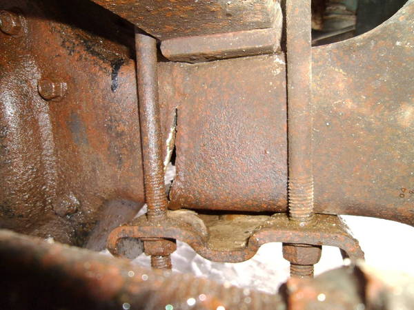

So this happened Sunday while plowing.
It would appear that a previous owner broke the front axle housing. And instead of replacing it, we`ll just weld that up. It`ll be fine. Not so much. I`m just really glad it didn`t happen the day before when I hauled two bundles of slabs to my Uncle.
On the plus side, there is a guy parting out a 97 F-350 4x4 dually on Craigslist. Sent him an e-mail last night, he got back to me today, and I`m buying the front axle, springs, track bar and bracket, steering linkage, and driveshaft for the exorbitant sum of $225. I`m picking it up Saturday.
