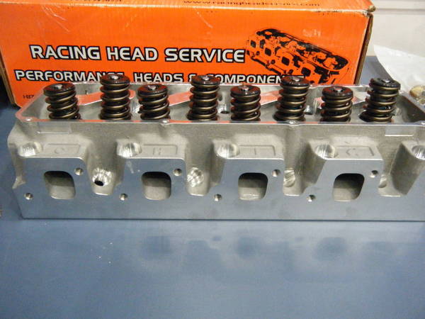

Here are some more pics:

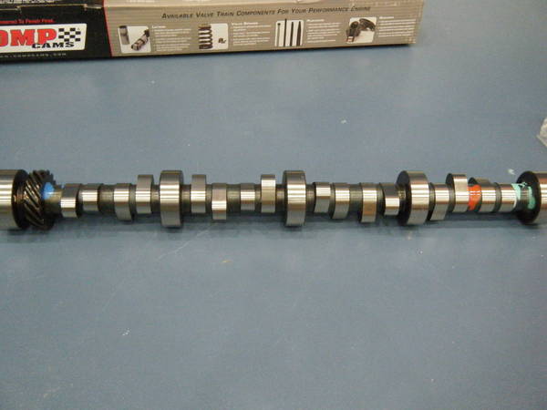

Roller cam...with 1.73 roller rockers lift is .602/.612 and 224, 232 @ .050.
LSA is 108 deg. Advertised duration 273/281. Comp Cams custom grind.

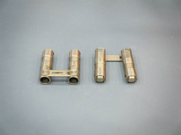

Lunati roller lifters with tie-bars:
hi DNFXDLI, i need a reference, im using the 3v heads, those lunati roller lifters with a very similar custom comp cam to yours and the comp cams double springs 924-16, do you know what kind of push rods tim is using on yours? length¿? I measured my needs but wanted to have a reference as i said before,
Thanx
Joe

Sorry Joe....I missed your post. I'm not sure what brand of pushrod he sold me, I will ask...or, Tim, if you see this..please respond :D
