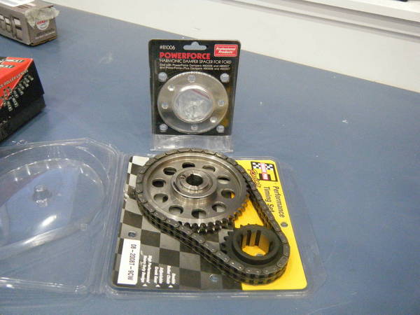

Timing chain/gears with HB spacer:

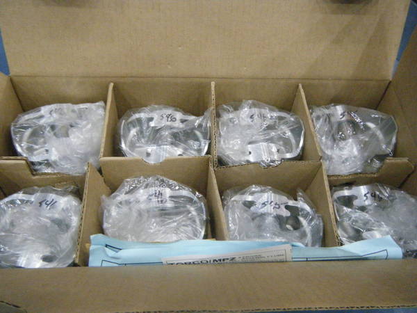

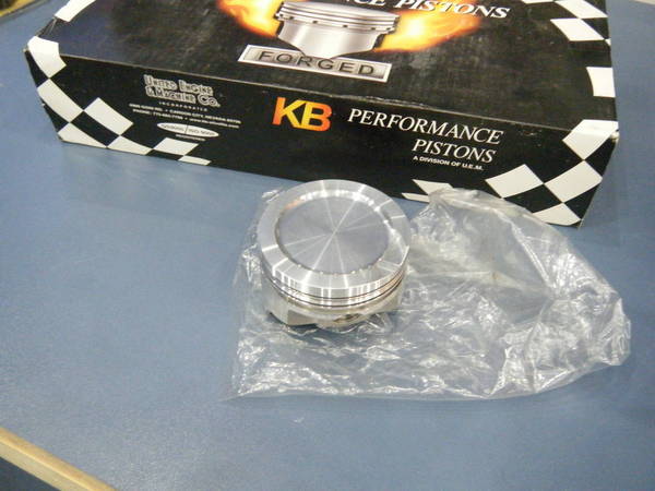

Forged pistons 16cc dish machined to reduce CR to 11.44:1..pistons weigh 545 and 546 grams.

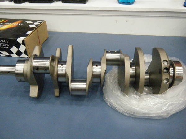

RPM Crank 4.25 stroke:

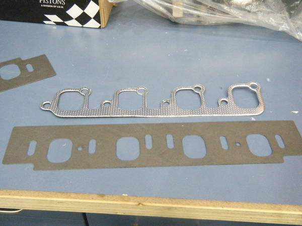

Intake/Exhaust gaskets....intake gaskets are custom made:

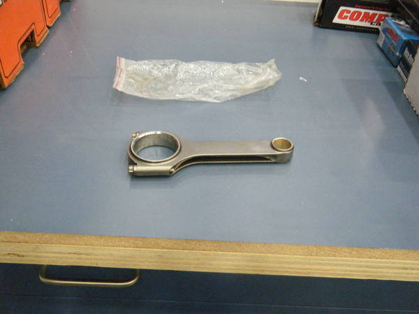

H-beam rods:

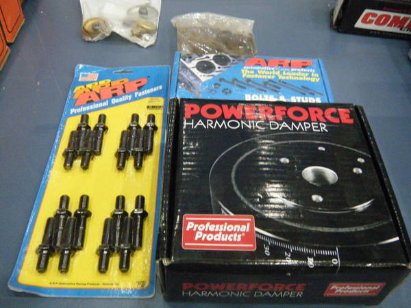

Rocker studs, Harmonic balancer:

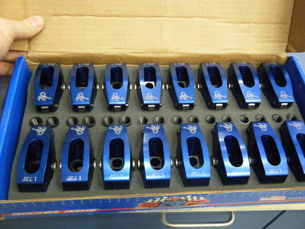

1.73 Scorpion roller rockers:

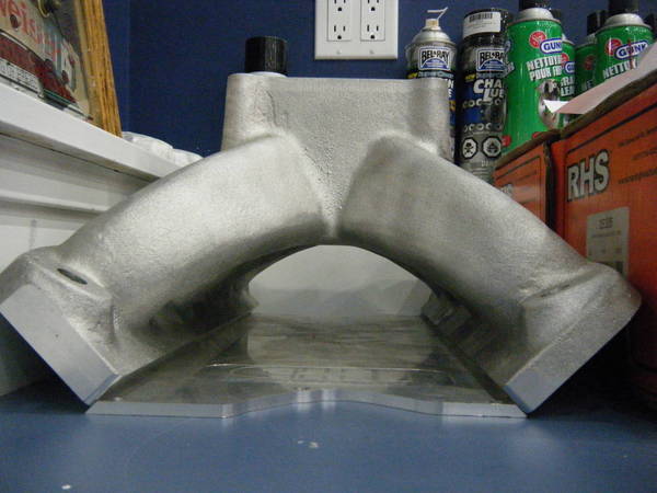

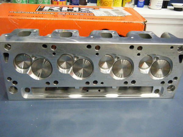

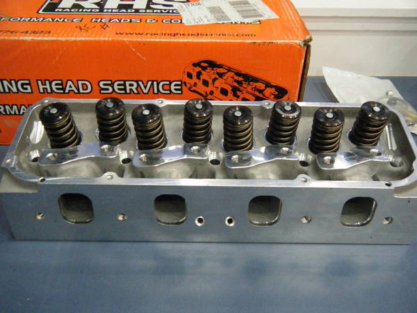

CHI Intake and and heads:
