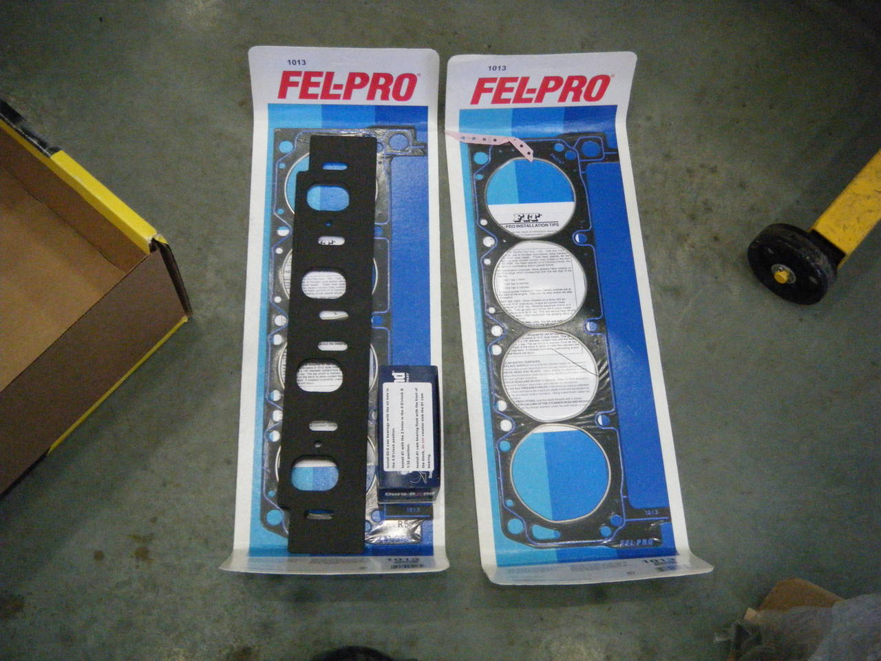

The intake gasket is manufactured for us by Cometic of a special material.
The material has an aluminum core with a "rubber type" coating.
Head gasket, just plain Fel-pro.

And....replacement gaskets for the intake and heads as well as an updated set of grooved cam bearings..procrastination paid off :D
