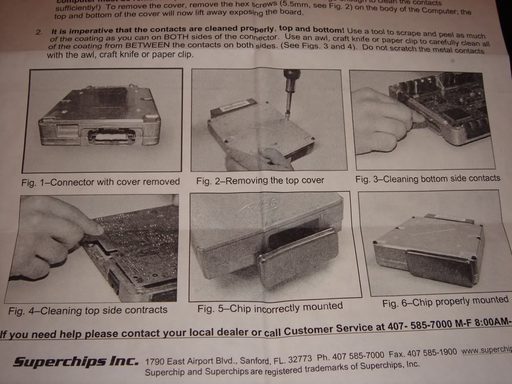

The port is there for programing from the factory am i right? Not designed for aftermarket. Make sure you get that sealant off of the computer board before you plug the chip in. If not then it may not work right or work at all..

Yeah the directions stress about 4928734 times that you have to remove all the material from the contacts on the connector with a blade or emory cloth. I'll make sure to do that ;)

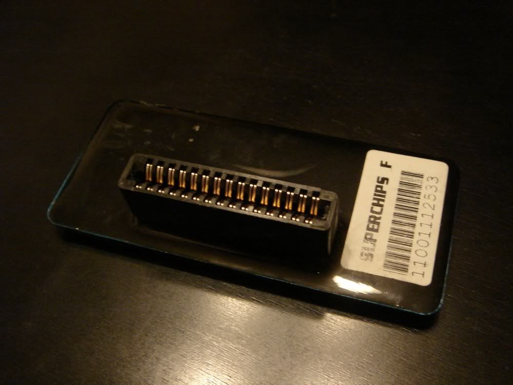

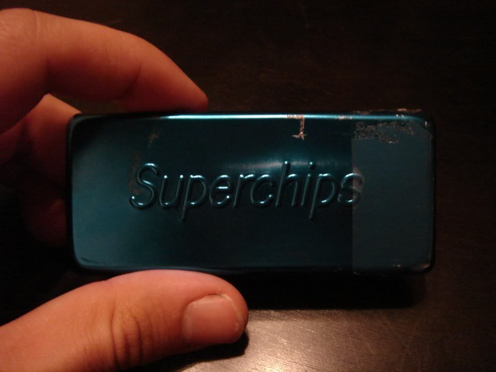

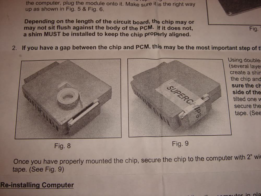

Pics of the chip & packaging... The chip has some scotch tape stuck to it from when he had it taped to the ECU.
