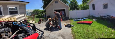

PS: Here's the new Straight-6. It's plugged in the right spots. We threw degreasers on her and the rain is now doing some work for us. Should take a little elbow grease in the morning to prep her for a clean install.
