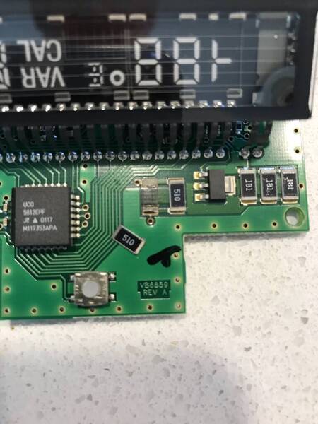

A very common problem with the Gen.10’s is the overhead display to stop working. Before you go and buy a new unit from the Ford dealership, remove the unit and look at the printed circuit board. The most common thing that prevents the unit from working are the 510’s (as seen in pic) that come loose from the printed circuit board. A few dabs of solder and you’ll have it working again.

Exactly Doug! I figured I would give it a try before spending the dollars for a new one.
