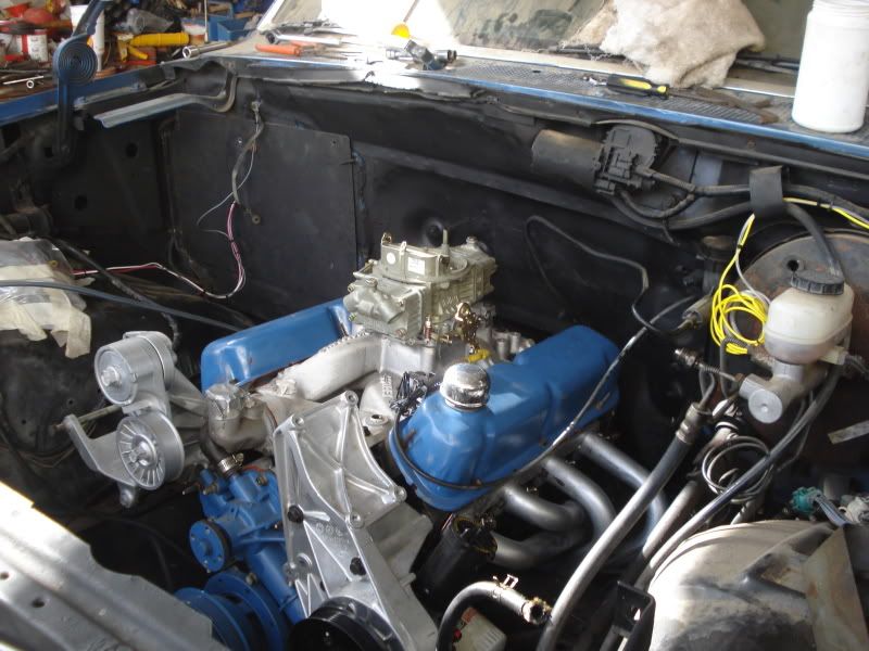

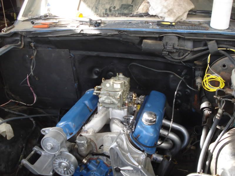

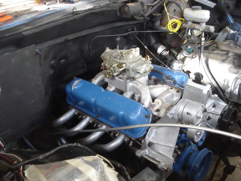

some HQ pics...
Throttle bracket and
headers are on and 75% of fuel system is on.. just gotta install the filter and regulator..

I see your smog pump isn't mounted. If you aren't going to use it, you might want to get an eliminator pulley. I tried mine without it and the tensioner couldn't keep the belt tight enough, even with a short belt. The placement of the smog pump pulley helps let the tensioner work.
i never had a prob with my old 5.8 when i did this.. so if it slips ill get a idler pully... but i do got the idler pully for the A/C...
