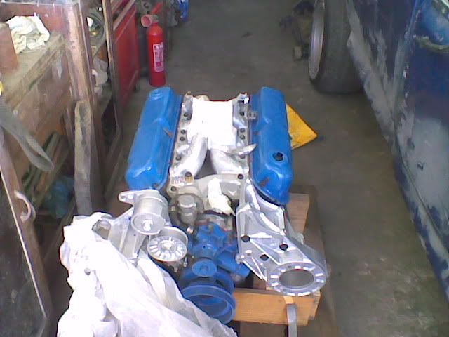

waithing for a little $ to come in and to order the last remaining parts.. so in the meantime i installed the engine about 75% of the accessories
can someone explain how the heck does those valve covers works? i dont see any breather hole or nothing.. just and oil filler hole

what did you get those valve covers off of?
those came on the engine 1996 Explorer..
i got some from an early 80's stang.. havent painted them yet.. just like the ones u have

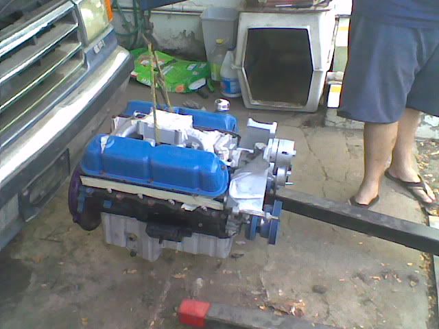

valve covers are on :) lots of work went into them they were rusteddd !!
painted with FORD blue :)
thats the theme.. silver and ford blue and black
BEFORE with the EFI valve covers i cant use.
AFTER: 80's mustang valve covers for carbed engines

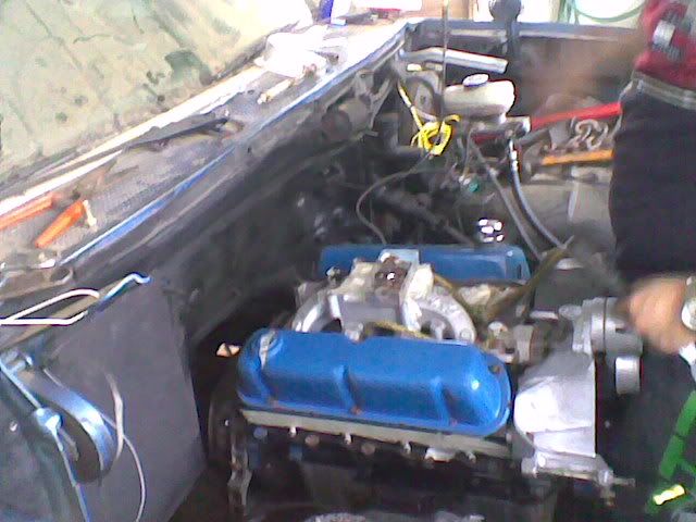

O.O :) the engine is in!!!!!!!!!!
on the ground:)
going in
Almost!
There!! in its place :)
