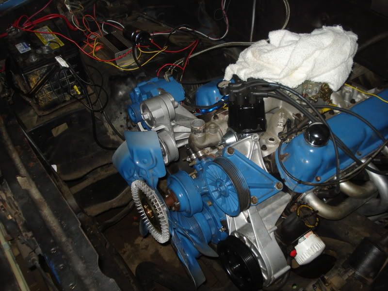

everything was ready waterpump cooling ps pump everything made it 10 meters out of the driveway BLAM! the waterpump broke the spacer we made to make it work witht he pully system i guess put too much stress on it..
i tracked down an <<<-1994 front timing cover.. and bought a new original 1989 F150 waterpump
becuase after 1994 the front timing cover switched (in explorers not F series) and uses different waterpumps and it was too short..
this saturday an army of friends is coming over and by saturday afternoon we will back!!!!! wish us luck!! pray to the ford gods!!

So the spacer makes the pulley actually stick out further than the other pullies?

nope.. it makes the shorter pump (for an Explorer 5.0 ) line up to the F series belt system..
if your wondering why i didnt get an F150 pump..becuase the timing cover after 1994 is different so i cant get an F150 pump to fit thats why i made the spacer ;)

ok got the new timing cover.. cleaned it up today tomorrow swapping of the cover will begin by tomorrow around noon we will be driving around :D
