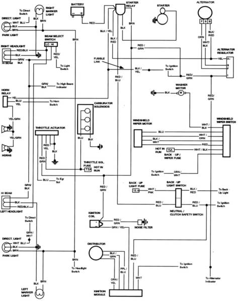

Here's a reference.
8,013
393
Boy that's tiny... I had trouble even with a magnifying glass, and I was too lazy to save it then blow it up...
Anyway, I was getting to the switch, like you said, step by step. What I wanted to confirm was that the turn signal and stop/hazards were different circuits. As such, there are 2 circuits affected, so then we look for the common areas, like the switch. Bulbs and harness are the other common points.
Section 32 might be easier to read here Roger:
