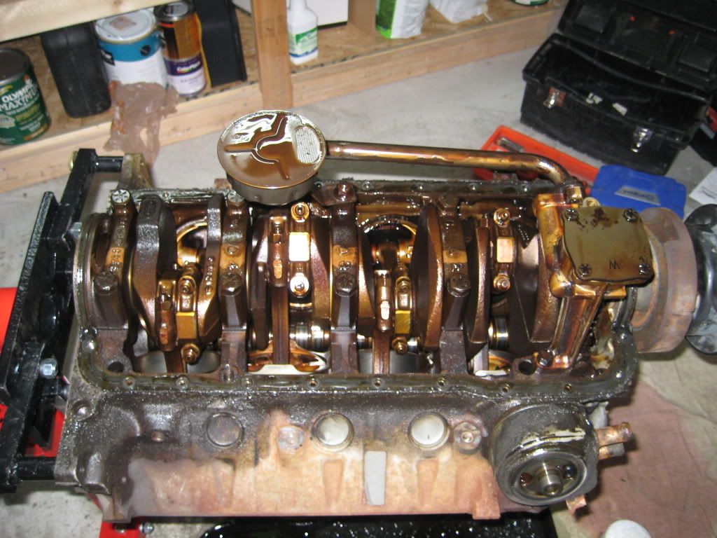

So... I finished the tear down. Everything looks stellar.

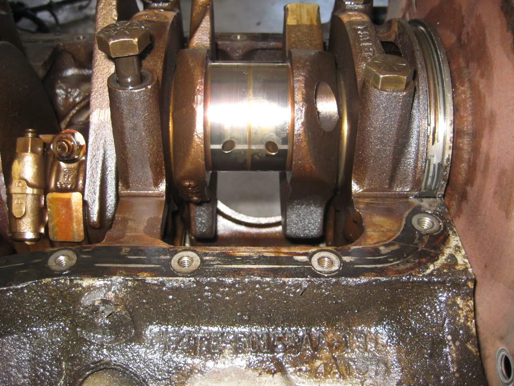

I didn't even need an extractor to get the pistons out. They just slid out gently. I am in utter disbelief on how little wear there was on the bottom end of this motor. The only ring that showed wear was the main bearing near the rear main. It was beginning to show a little copper through the plating.

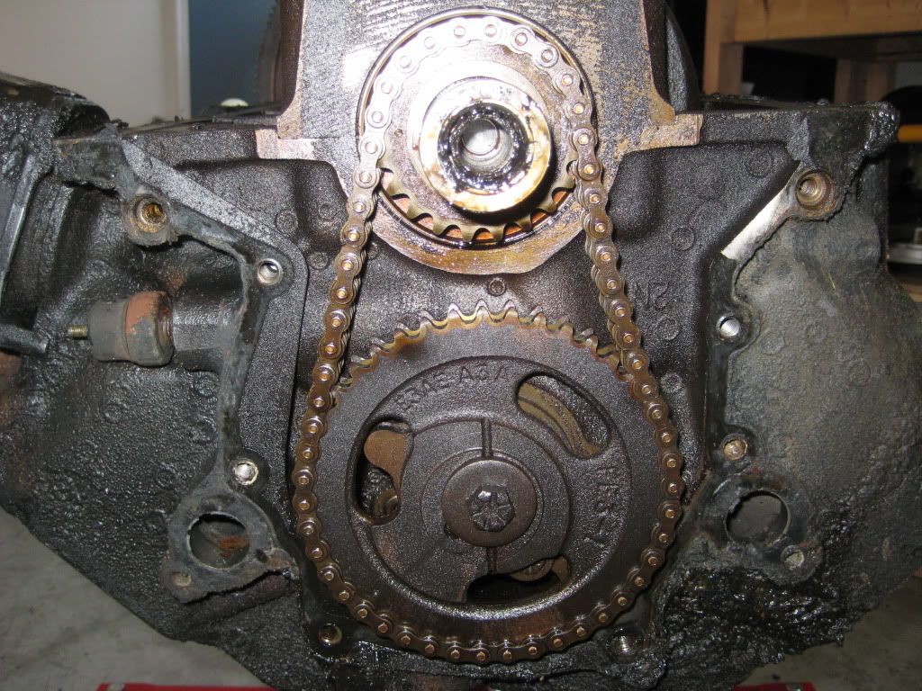

I have a little slack in the timing chain.
The craptacular stock Ford camshaft:

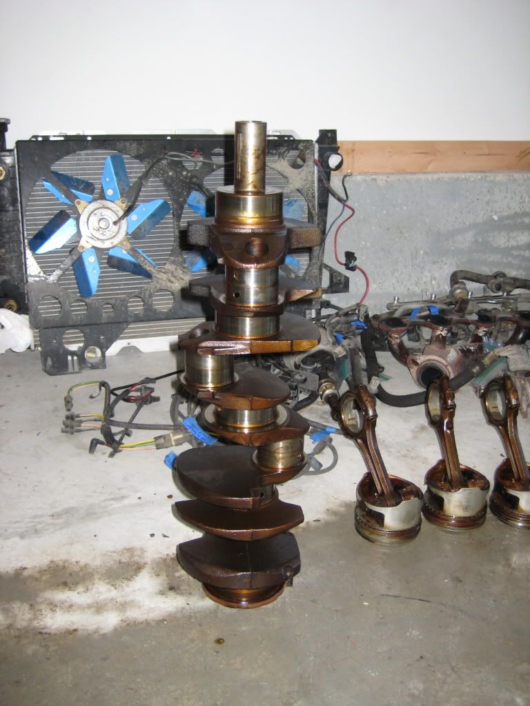

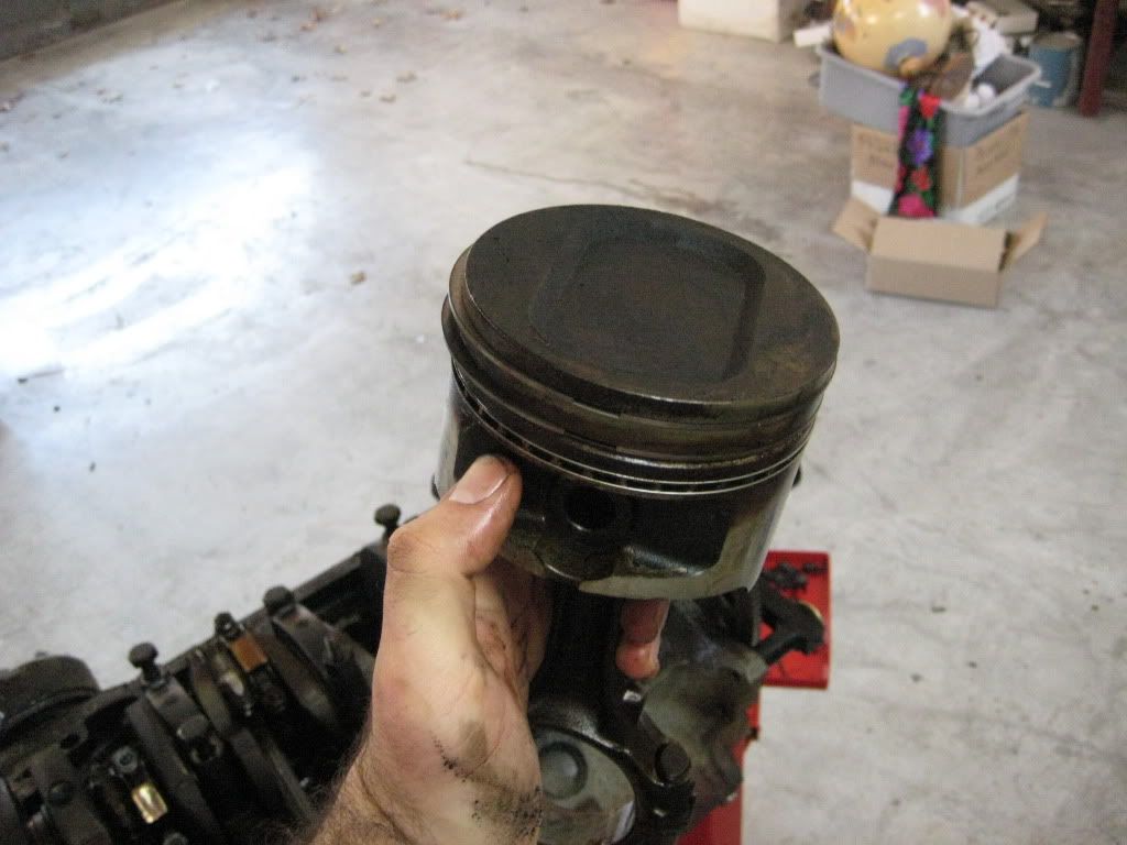

A typical piston... they were all very clean, all rings were reasonably worn, no serious blow by.
My first couple piston/rod combos out.
Got 'em all out.

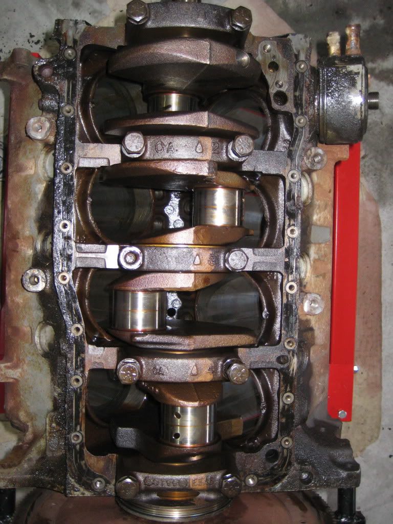

Crank is out!

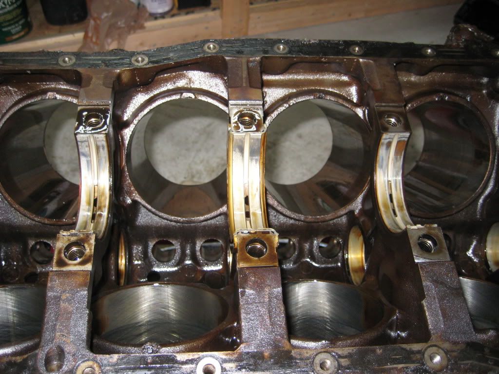

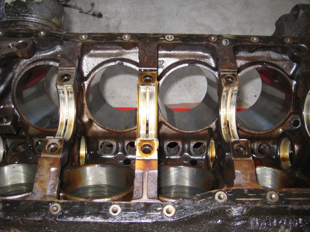

Here are the piston walls from down below. I know the camera isn't that great but these cylinder walls are clean as a $*%@!%er

Is it my eyes or can you still see the crosshatch in the cylinders?
Looks like you've got alot to work with. Did you run synthetic oil???
For a while (when oil was more affordable) I ran synthetic, but I switched to Motorcraft Synthetic blend about 60,000 miles ago.
And I don't think it's your eyes....

It happens. Running synthetic oil and keeping it changed regularly works wonders on an engine.
If all the cylinders look like what I'm seeing in the pictures, I'd just hone it to break the glaze and put it together.
I don't know how much you trust your machinist, but don't let him sell you a bore out if the block doesn't need it...
