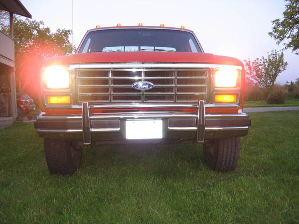

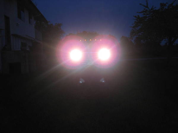

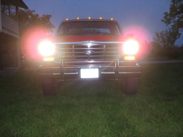

Hi tedrow42, it did come with the standard sealed beam headlamps, 6054's, but I wanted a modern lens that allows you to just replace the bulb. And there's the cool factor with the Hellas :)
