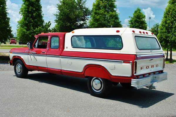

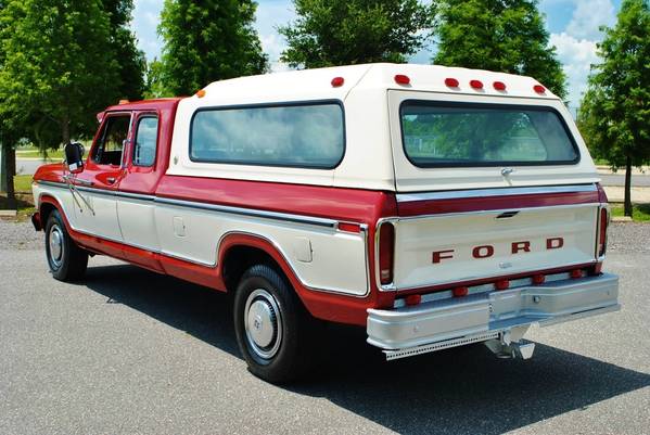

Also, what are those covers above the wheels on the back?
Some pictures show them, some don't....is that something you can just take on and off?

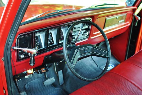

Also, also, the arm rest on the door looks to be a different shade of red than the rest of the door. But still a very nice truck

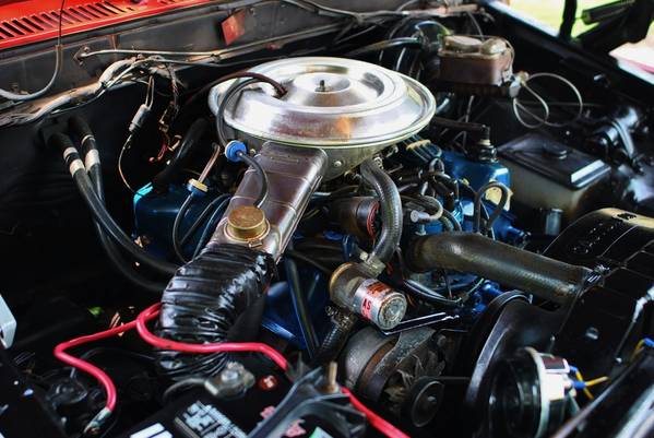

The black under the hood is defnitiely not factory, but maybe could be rust protection, but I have never seen it just on the sides.

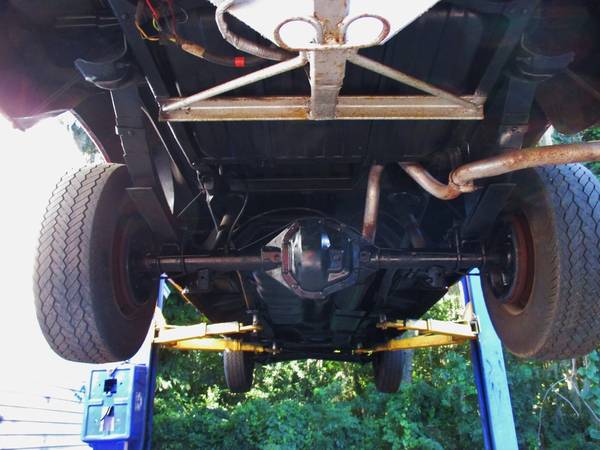

It is nice looking, but I have a very difficult time believing somebody bought it and then barely ever drove it all these years. Also, the entire underbody was just shot, look around where they welded the hitch on. Also, if the paint were original, then how did all that rust get on everywhere else? Just a number things I am seeing that says no, not that low of miles. Nice restoration maybe.

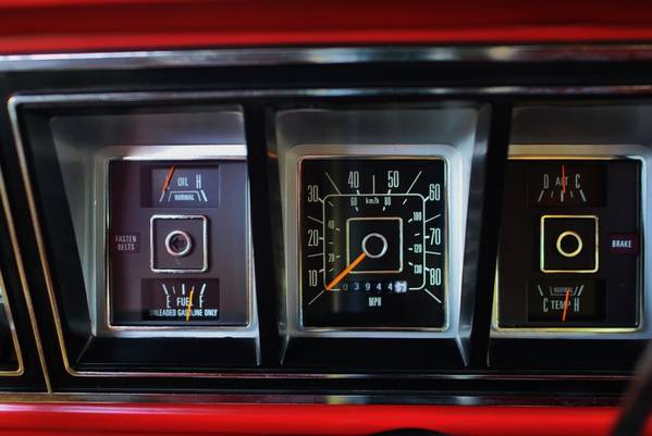

I'm not a believer that it's original either. While not a fool proof way, but typically, if one of these odo's have been rolled, the numbers won't align, like in his pic...and the brake pedal wear tells me more than 4,000 miles too. As pointed out, the undercarriage looks worse than a 4k rig, I wouldn't imagine the rust at the seams would be there either, and I think the black paint in the engine bay is there to hide sins. Clean truck for sure, but I'd bet it's 104k that's gotten one helluva detail.
Oh...and those wheel skirts are the first I've ever seen for a 73-79 truck...can't tell if I love them or hate them yet.
It looks like the speedometer and gas gauge have been changed out, since the needles are a lighter color, which is indicative of the earlier style gauge cluster pointers. But it's hard to tell because of the camera angle/light conditions.
Ken, I think those fender skirts just snap into place. I don't care for them. I also wonder why the buck tag under the hood has two different colors of paint on it- red and black.

Dang!! That's unbelievable! Those rear wheel well covers are a after market item Ken, they are easily taken off and put on again. I don't care for them myself. Not sure what to make of the engine compartment paint, never seen that before. My old Ford was all orange through out, including the original paint codes still on the underside hood and fenders. It sure is a time capsule for sure!
