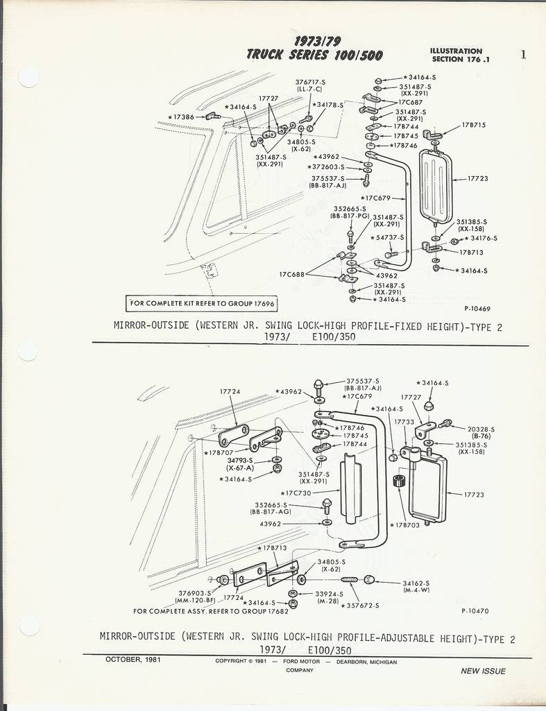

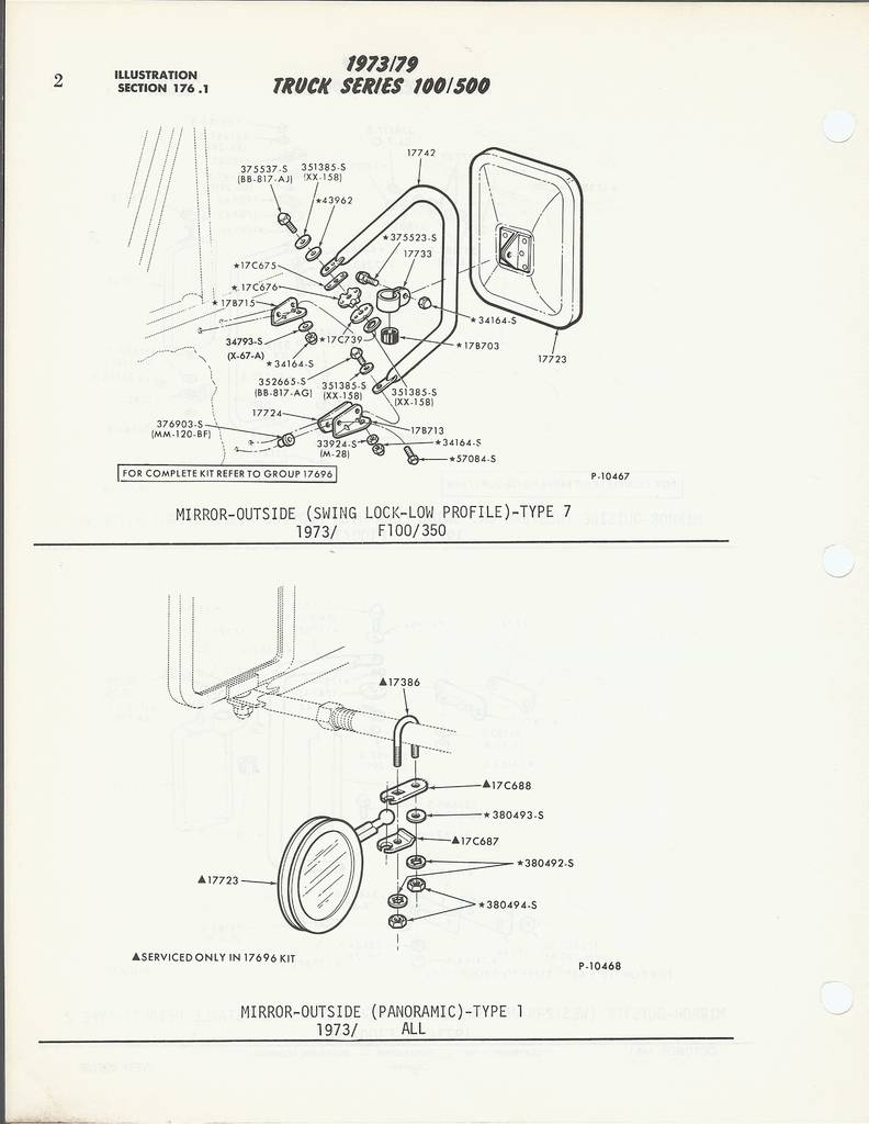

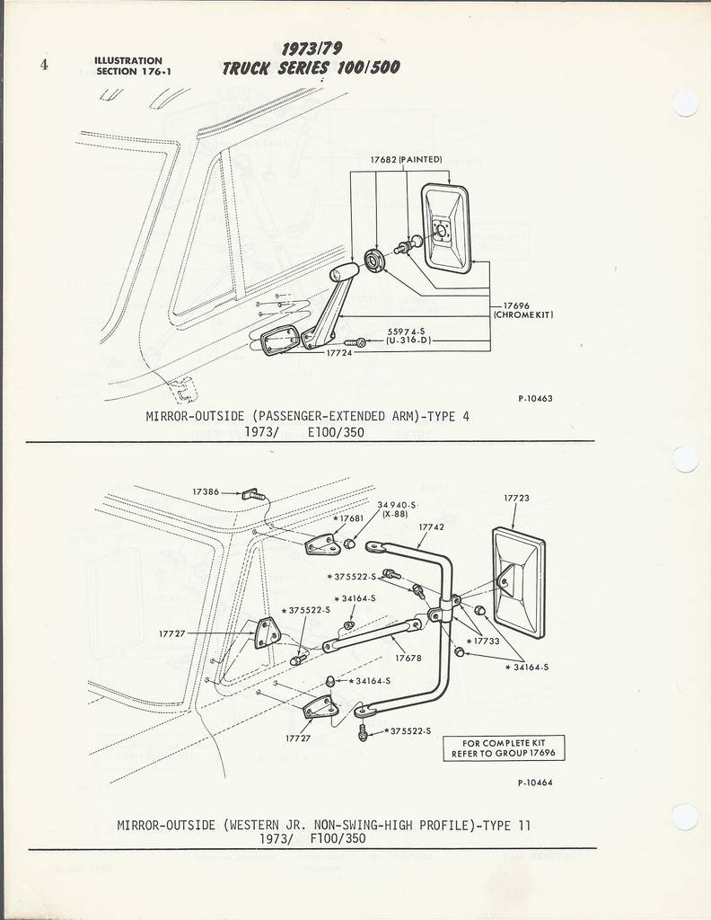

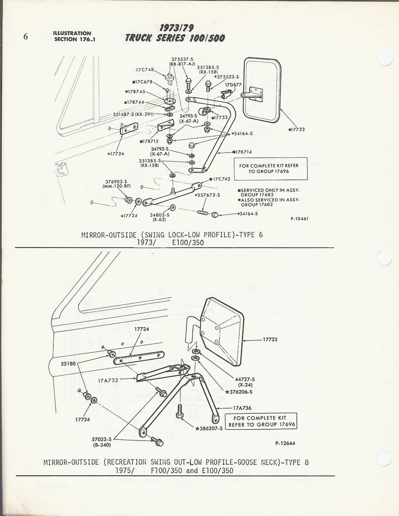

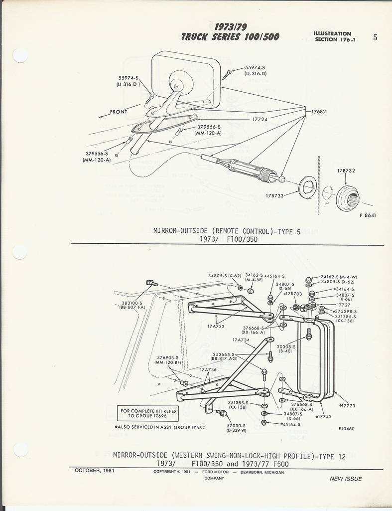

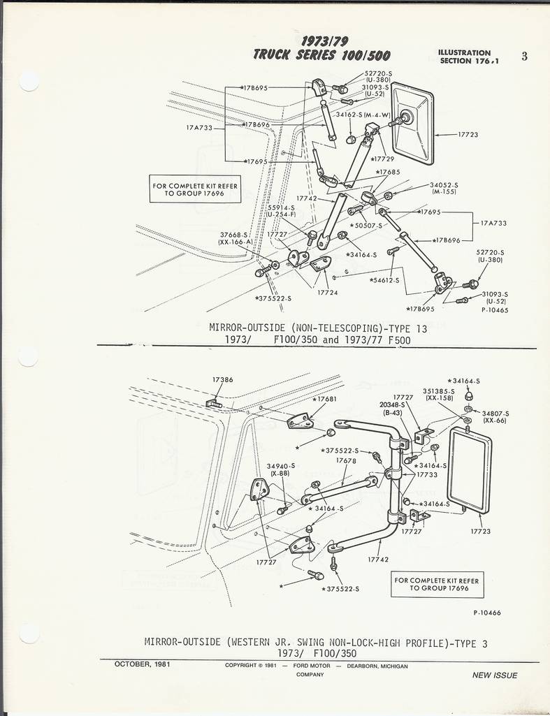

I've got a diagram of the various types that the trucks used, I will see if I can find it.

I couldn't find the one picture I have, but these should help. Those are Ford mirrors, or at least made and supplied to Ford.
That remote one also had a matching non remote mirror.
