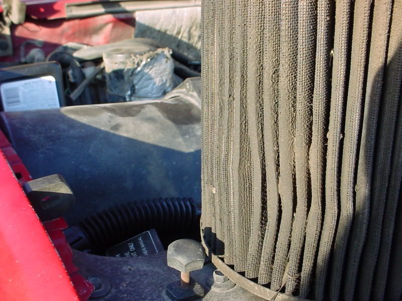

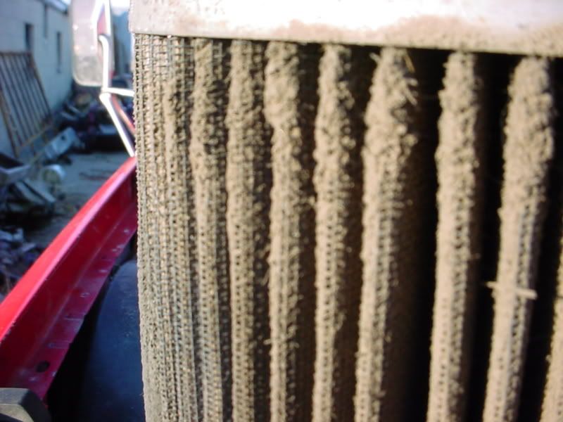

Got a couple pics of the K&N we have on the Cummins, got plenty of dirt on it in not that many miles, but this truck runs in dusty conditions, a prime example of why I would never let the cleaning go as long as the manufacturer says... might have 10,000 miles on it at best
