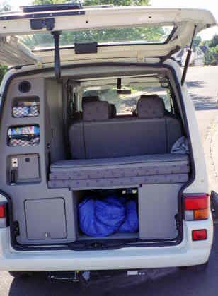

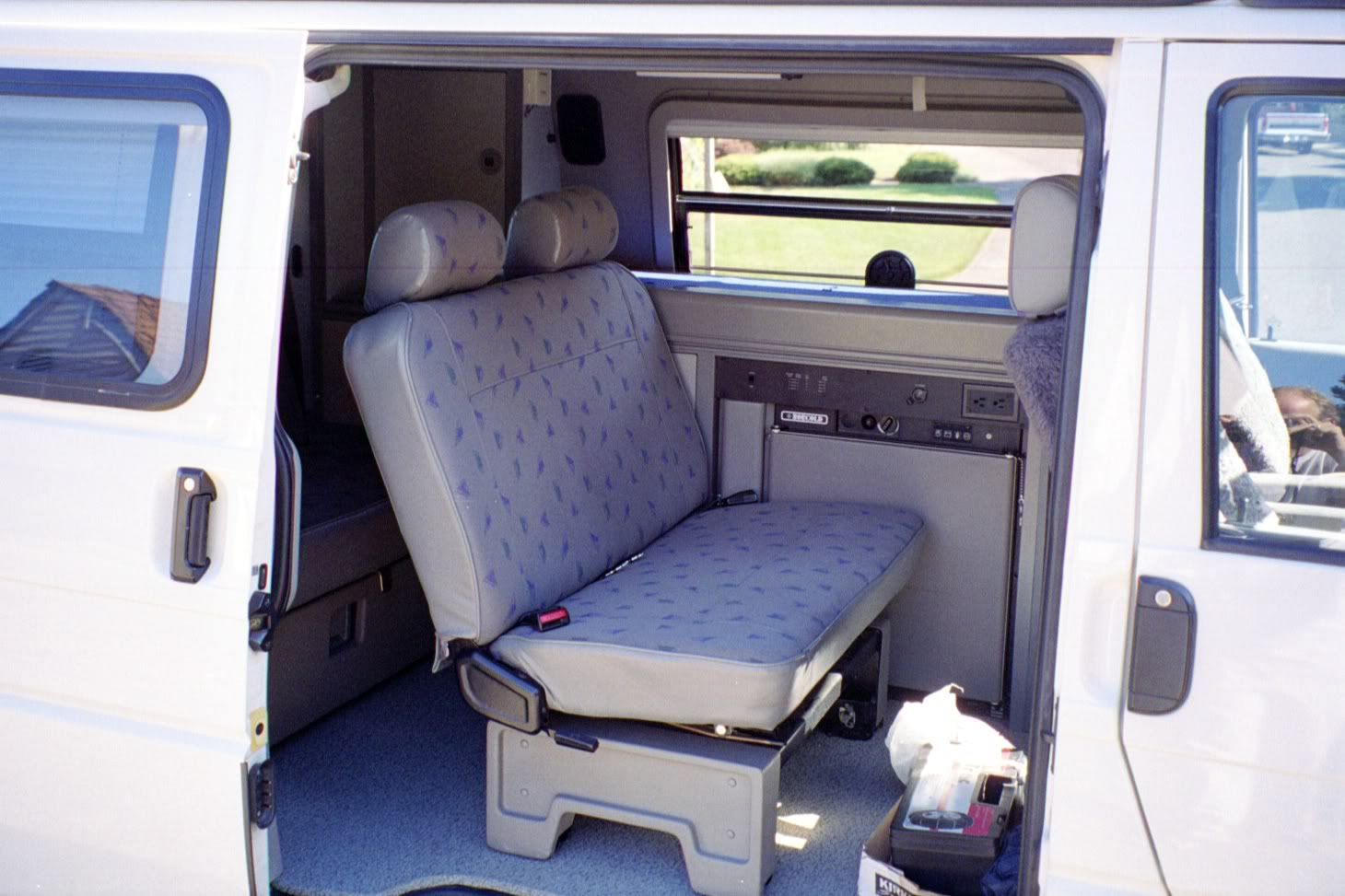

OK- for about 7 years, this was the Bear camping rig.
Inside, it had a 3-burner propane stove, 12-V propane furnace, 3-Way (battery/110V/12V) fridge, sink, fresh water/gray water storage, and 110V exterior plug-in. Power was a double-battery setup with isolator and built-in inverter.
Out back, an exterior shower and storage.
It slept 2 adults, 2 kids... if they were friendly. "Tight," but incredibly efficient.
We had a 5X8' Wells Cargo enclosed trailer that we pulled behind it. In that we had tent, outdoor cook stove, outdoor canopy, and all the other "normal stuff" you'd take along. The VW did everything from summer beach trips to winter ski runs, and spent more time off-road (cautiously- limited ground clearance) than the pickup.
While that may not be the answer, we learned some important things camping with it.
1. It's amazing how much stuff goes along that you don't need. Generators and electronics, for instance. Didn't have 'em, didn't need 'em.
2. A good, sturdy outdoor canopy is as or more important than the tent. Food prep in the winter and a shady spot in the summer, for example.
3. We kept all routine camping gear and non-perishables in Tupperware totes, clearly marked. Made packing up a snap. Cleaned and re-loaded them with each outing.
Hoping there may be an inspiration or two here.

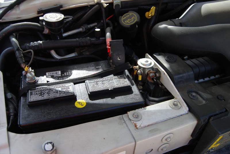

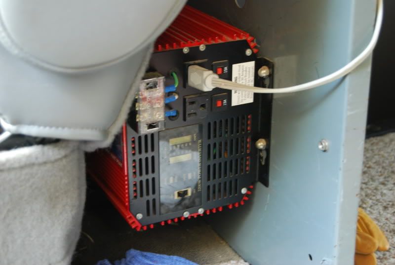

My inverter is in my 04 E-350 work van.It's not a camper or rv.
2300 watt inverter mounted on partition behind passenger seat
Solonoid to turn it on and of is on the bracket I fabed. The switch is on the dash. Notice the size of the wires coming off the battery. I think they are .00 welding cable (I can't remember what size I bought) It takes a lot of current to push 2300 watts.
Inverter 101....
Most inverters that you buy from auto stores, Wally World and the like are modified square wave inverters....they are not a true sinusoidal wave but are a square wave that is shaped by the switching transistors or FETS to kind of simulate a regular AC waveform....the issues arise from the fact that most electronics these days have electronic switch mode power supplies in them that do not like modified square wave..a lot of microwaves have issues with them as well. Those kind of inverters are best suited to power incandescant lamps, halogen lamps or motors with no electronic speed control.
Then there are the true sine wave inverters which produce a utility grade waveform which should really be used for all other things...end of story. Samlex America and Outback Power are the best...period....and that is the simple fact of the matter.

How big would I need to go. I'm not thinking about having to use it for anything real big. I was thinking camera/camcorder battery, cordless powertool battery, flashlight, cellphone. etc.
You could go with either a 300 or 600 watt inverter....the Samlex ones would fit the bill nicely.
