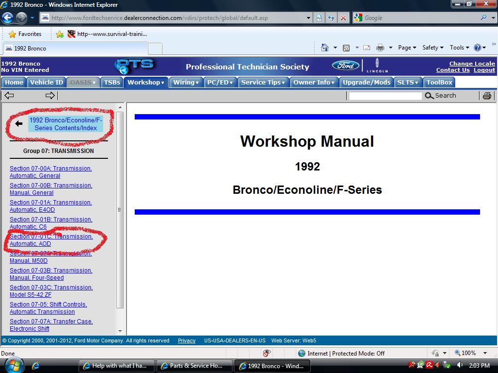

Not for sure why would they drop it from the bronco but not te F150??
I have a 92 with a factory AOD...
But they're still showing shafts for Bronco years 92-96 for sale on multiple auto supply stores online.
Per my Kelly Bluebook Blue Book New Car Pricing Manual, third edition, 1992:
The EOD was the only automatic available on the Bronco.
On pickups, however, the AOD was still available in F150 Regular Cabs with the 4.9 & 5.0 L motors (XL Trim only), and on Extended Cabs with the 5.0L motor (no trim restrictions).
The reason, I'm guessing, was price. The AOD was rougly $190 cheaper than the EOD, and fleet bids made up a large portion of the pickup business. Same reason a three-speed Automatic was offered on F250's that yr w/GVW's over 8500 lbs (n/a on 7.5 or 7.3 motors).

Per my Kelly Bluebook Blue Book New Car Pricing Manual, third edidtion, 1992:
But my flareside is an XLT..... But other than that this all makes since

Wasn't looking at Flaresides. That came as part of a Special Value Package (code 47E), only available in the states of Texas, Oklahoma, and Louisiana. Showed a discount of $1105 wholesale and $1300 retail.
14,464
384
I'm figuring that is like all order books.. They group the trucks broncos and econolines together even if some things like the AOD may not cross over.. Why have 2 different manuals because minor differences like a transmission option
Im with Chris... E4OD is the only one with the OD cancel button. E4OD is the only one that was available behind a 351.
You're wrong about that, AODE equipped vehicles also have the cancel button in the end of the shifter. I am changing my vote to E4OD as well in your FSB.
It is a E4OD.... I'm telling you
You guys are almost always spot on with this rigs!!!! Thanks a bunch..
Just got it back yesterday from the garage and the verdict is: E4OD! smilieFordlogo
