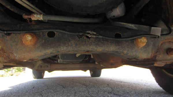

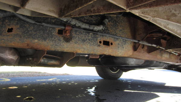

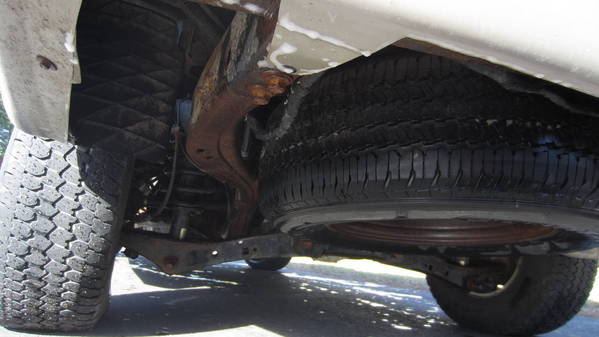

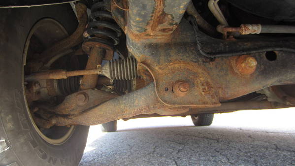

I did ask if he'd email me pics of the underneath and engine bay and that's where my concern is. Not too concerned as it looks like surface rust, but thought I'd check and see if you had any thoughts before we went through with the deal.
^^^working on posting pics he just sent of the underneath.
^^^2 more coming.
Woo that's a lot of surface rust...
We're a tad concerned about it.....it almost looks treatable with some chemicals, right? I don't see any rot.....it is a New England vehicle.
Think it's a deal breaker?
I'm not familiar with weather conditions in the Northeast, but my concern would be the amount of corrosion on that A/C or transmission line(whichever one it is) That looks like more than surface rust.
Other than that, I know nothing......
I don't think that amount of rust is unusual for a 6-7 year old vehicle in your region. Having said that, my 2005 F150 with 170,000 miles has much, much less rust than that. I'm a little leery about that much frame rust. This part of Missouri does not have a 'southern' climate, so my truck hasn't gotten a spoiled life of no road salt.

Doesn't seem to be a crazy amount of rust...I'd want to look at it in person.

The factory paint/covering doesn't last real long any more, and with the nasty crap they put down as pretreatment on the roads these days, it doesn't take long to rot up a vehicle. The frame rust is minimal to what I am used to. I would be more concerned about thinner material like floor pans and rocker panels. My mom's 02 Buick is rotting up more than I would like, but that is the nature of the crap they put on the roads these days. It also has nearly 400,000 miles on it... Lines are replaceable, I wouldn't let that stop me if everything else is clean. The important part is what cannot be just bolted on that is damaged. If all sheet metal is clean, I wouldn't worry too much about the rust.

That rust looks normal for the area we are in Ken.
I wouldn't worry to much about it like Roger said.
If it is possible to go down south VA or lower you will find rust free but the downside is it is harder to find 4x4's down there.

Definitely normal for a 6 year old New England vehicle....still has decent miles at 75k and for the price to book....not bad at all.
It's official......spent a lot of time w the po....frame is super solid. ...rockers will need some attention soon, but rest of the vehicle is immaculate.
