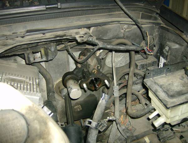

Mar 10, 2011 Moderator #21 blacksnapon Moderator Staff member 9,461 301 waynesville,mo. master cyl, ps lines
Mar 10, 2011 Moderator #22 blacksnapon Moderator Staff member 9,461 301 waynesville,mo. pcm connectors, connectors under ps reservoir

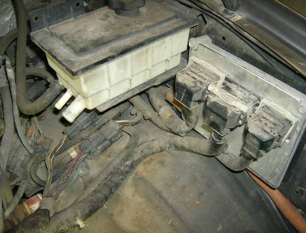

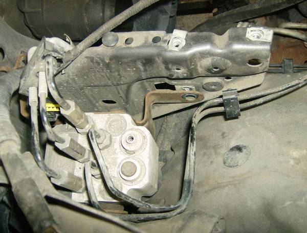

Mar 10, 2011 Moderator #23 blacksnapon Moderator Staff member 9,461 301 waynesville,mo. abs controller

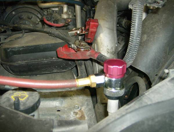

Mar 10, 2011 Moderator #25 blacksnapon Moderator Staff member 9,461 301 waynesville,mo. connector under driver battery for fog lights

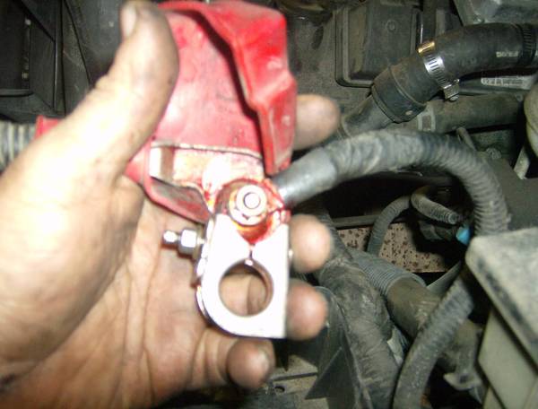

Mar 10, 2011 Moderator #26 blacksnapon Moderator Staff member 9,461 301 waynesville,mo. remove nut and route wires to pass side
Mar 10, 2011 Moderator #27 blacksnapon Moderator Staff member 9,461 301 waynesville,mo. recover freon

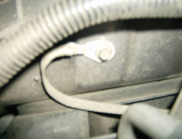

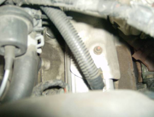

Mar 10, 2011 Moderator #28 blacksnapon Moderator Staff member 9,461 301 waynesville,mo. ground strap pass side under windshield

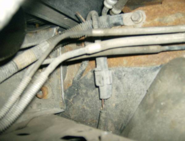

Mar 10, 2011 Moderator #30 blacksnapon Moderator Staff member 9,461 301 waynesville,mo. Whats not shown, a/c lines on the dryer, and in front of the radiator (pass side. Theres an electrical connector, and ground on the pass fender. Set the rack, lift the cab.

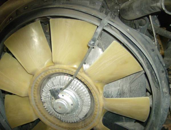

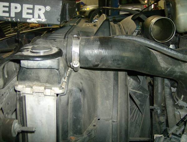

Mar 10, 2011 Moderator #31 blacksnapon Moderator Staff member 9,461 301 waynesville,mo. remove the fan and shroud.

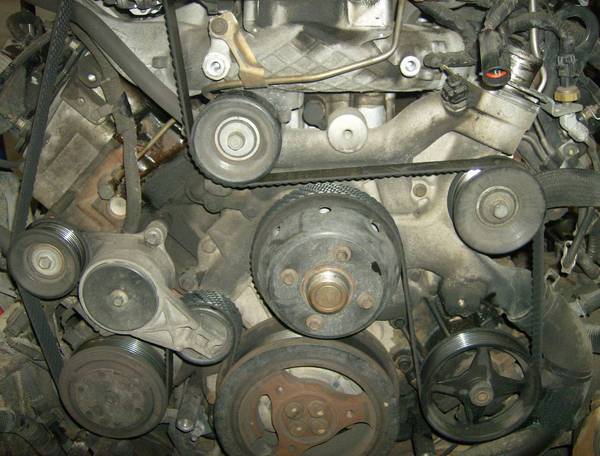

Mar 10, 2011 Moderator #32 blacksnapon Moderator Staff member 9,461 301 waynesville,mo. remove fan belt

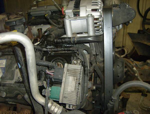

Mar 10, 2011 Moderator #33 blacksnapon Moderator Staff member 9,461 301 waynesville,mo. alt and glow plug controller

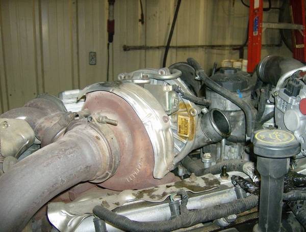

Mar 10, 2011 Moderator #35 blacksnapon Moderator Staff member 9,461 301 waynesville,mo. turbo pedestal, engine wiring.

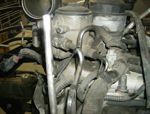

Mar 10, 2011 Moderator #36 blacksnapon Moderator Staff member 9,461 301 waynesville,mo. fuel lines, fuel and oil filter housing REMOVE INTAKE MANIFOLD

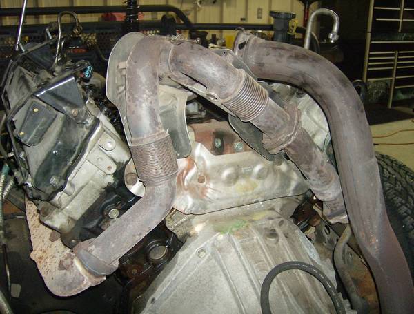

Mar 10, 2011 Moderator #37 blacksnapon Moderator Staff member 9,461 301 waynesville,mo. remove exhaust

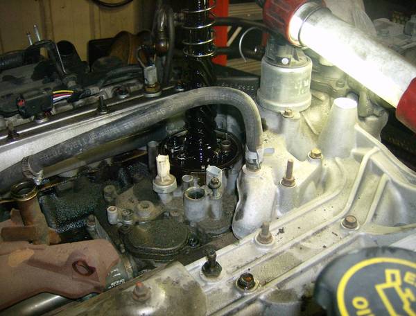

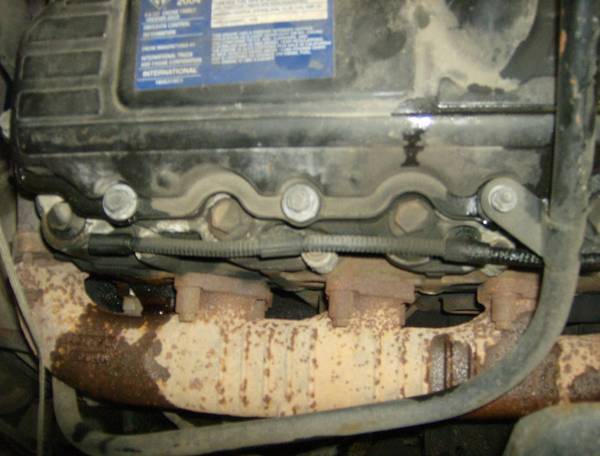

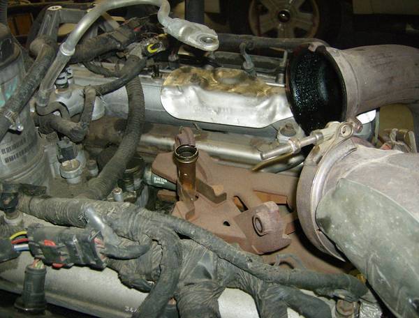

Mar 10, 2011 Moderator #39 blacksnapon Moderator Staff member 9,461 301 waynesville,mo. pass exhaust manifold and trans dipstick

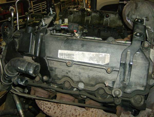

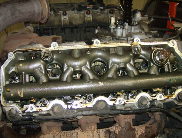

Mar 10, 2011 Moderator #40 blacksnapon Moderator Staff member 9,461 301 waynesville,mo. remove valve covers
