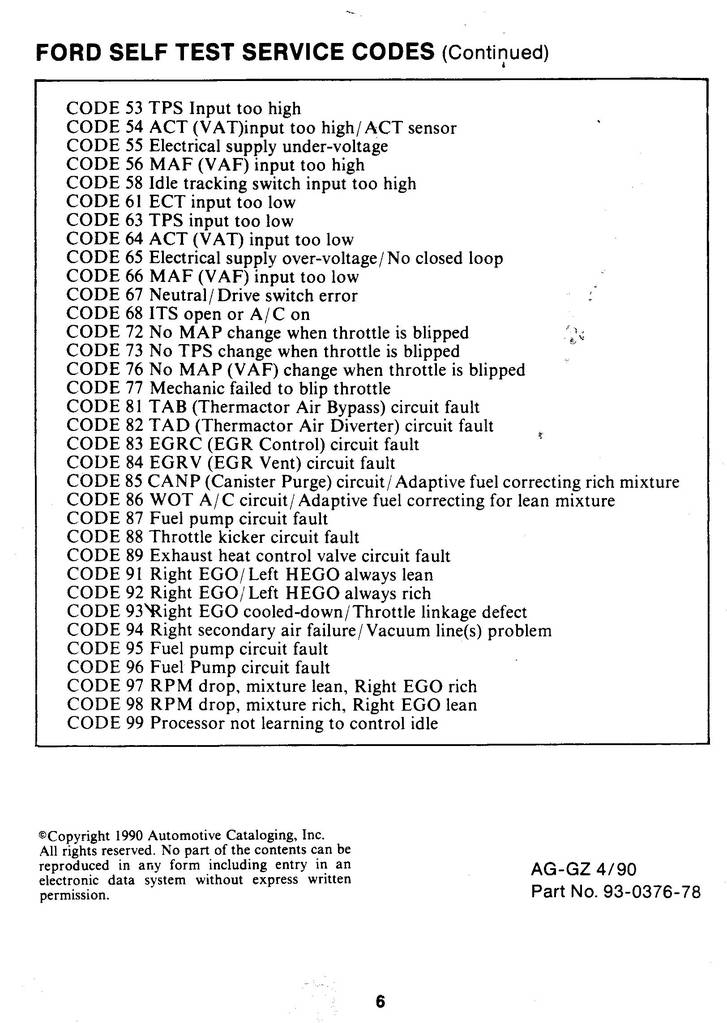

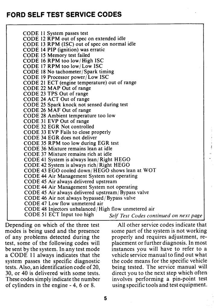

Ford Engine Control Computer Step-By-Step Installation Instructions
