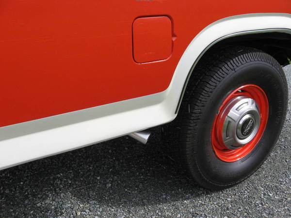

Since I can't really afford good quality headers just now. Also the thoughts you guys put in my head about breaking exhaust bolts off really put me off (for now) So, I would like to duel my truck out eventually of course. Just thinking about where the mufflers should be. I have changed my mind several times on where I would like the exhaust to dump. I think I will have the pipes ran all the way to the back bumper. Also thinking about putting a couple short glass packs right there at the rear. Is this good thinking? Or I am sure there is good reason mufflers are closer to the front. What think? Thanks Gents

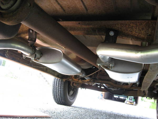

Ok, so if say my pipes were 2 Inch and ran from front to back. Could I get away with no mufflers? Would it sound trashy? How about letting off the throttle like when going down a hill. Wouldn't it snap and pop like a 8itc#!
I don't know why, but I remember being told the optimum place to put the mufflers was at the initial hottest point of the exiting exhaust. The way I was told to do it was a thin layer of spray paint on the exhaust pipes (usually 2-3 ft behind the collector) is where you'll notice the burn off, and that's where you wan the mufflers. As I said, I don't have a clue why. You want the mufflers at an equal distant to maintain proper back pressure. I've always been a fan of 2.25-2.5" pipes for stock to mild engines. Remember with glass packs, the shorter they are and the bigger the diameter, the louder they are. As for straight pipes, they're pretty loud and obnoxious, have to be careful with noise laws. Straight pipes are usually reserved for folks that think it sounds cool.

Hey Roy, I like this very much. I have seen complex systems with like cross pipes and although I'm sure there is science behind it? I guess I don't care to understand so much of it. I like this, really. Does it sound good? I mean does it make you smile when you shovel the coal to it? I myself have a hangup about glass or steel packs. I like the sound. We have a long driveway with several neighbors to either side and I want my neighbors to know when I'm coming home. Not obnoxious noise. Just sweet Ford music. Ya know? I truly hate a ratty exhaust sound. I want distinction. I want my sound. Not someone else's sound. Ya know? Thanks Roy and I have visited your gallery as well as many others. I plan to get them all visited. It will just take a while. Yea, I tell you guys what! Most of the Fords in here can damn near promote a stiffy! I guess that's some more of them FTF symptoms? Yea, no doubt.
good morning:) since I use the truck for my work, it has to be presentable, so no loud exhaust, but it does sound nice and I recently put on shorty headers which really made the idle nice and more sensitive gas pedal. No big gains, but definitely notice a difference. The X pipe helps for sure, but I just wanted a straight off the manifolds, keep the cost down, true duel system, still cost a bit, but you get what you pay for.
If you want a nice tone, I'd stay away from the glasspacks. The crossover pipe will improve the torque a bit at the bottom end and also smooth the sound out.
Ok, No glass packs. Got it! Tell me Sir. Tell me what to be looking for in a pair of mufflers. Right down to the brand name. Where is best to exit the exhaust for best sound. Stuff like that. Everyone, please feel free to chime in. I am working a deal with my Granddad and if all comes out right, he will put new exhaust on my truck as payment for my labor. I'll fill ya in on whats up later. Thanks guys.
