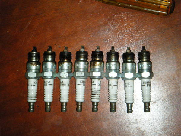

Plugs were in decent shape...one was wet...the closest to the driver...this was also where the most sludge in the coolant passages was...don't know if there is any correlation.

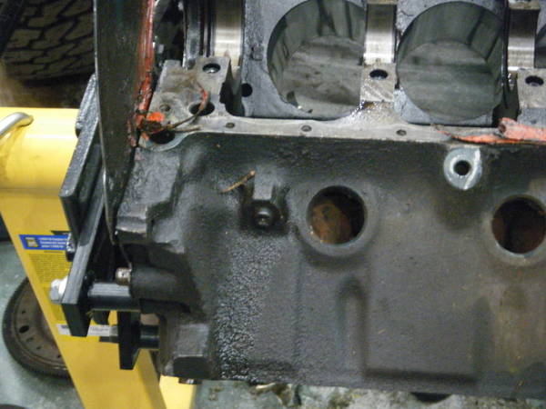

The offending plug that has been soaked many times and won't budge..also the same location of the block sludge...heat will be applied next.

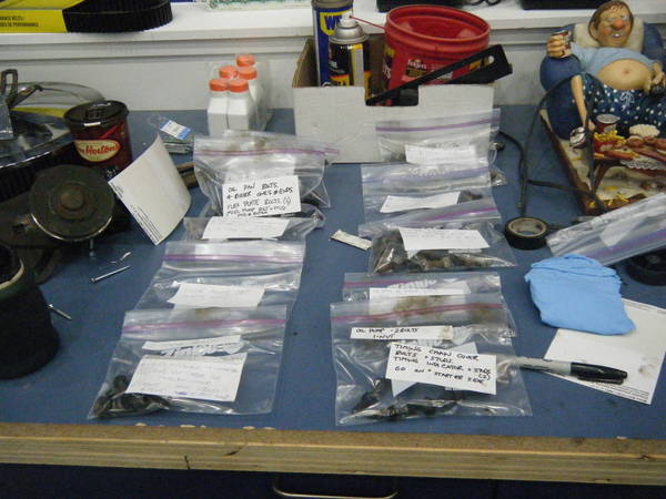

Everything bagged and labelled

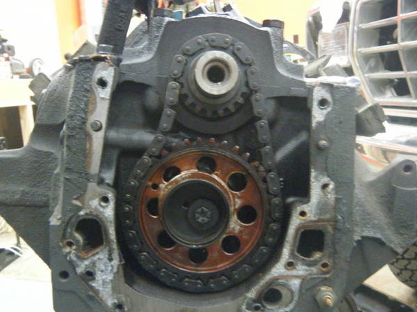

Timing chain was not too sloppy

Duncan #8 is the prime spot for sludge and plug fouling.
Especially on the 351M/400 do to the oiling system.

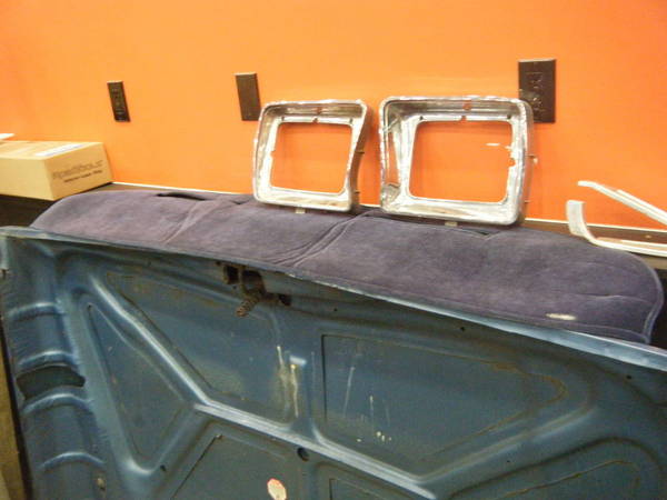

These buckets and dashpad I will mail to whomever for the postage
pm sent....
I didn't get a pm....but someone had already sent one much earlier...if he backs out, I will contact you.
Thanks Dennis....a prime example in this case!
