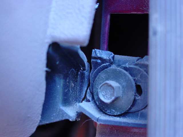

I performed a TSB on my truck a while back, involving the replacement of a plastic dashboard bracket with a metal bracket. The bracket that came on the truck was prone to breaking on the passenger side, leaving the passenger side of the dash unsupported, which creates lots of rattles and squeaks. Ford put out a kit to fix this: a metal bracket and some pop rivets. You saw off the remainder of the broken bracket then rivet a metal one in it's place.

No it couldnt be more simple. Remove the passenger kick panel and the broken bracket is exposed. Saw off the remaining bracket parts (shown in Bill's pic up there) and use a pop-rivet gun to rivet the new metal bracket in place. Bolt that bracket into the hole on the body where the old one was attached (use the old bolt) and put the kick panel back on. Real simple ;)

Remove the passenger kick panel. The bracket that breaks is the bracket that attaches the passenger side of the dashboard to the passenger side of the truck body (painted metal). You'll see it as soon as you remove the passenger kick.
