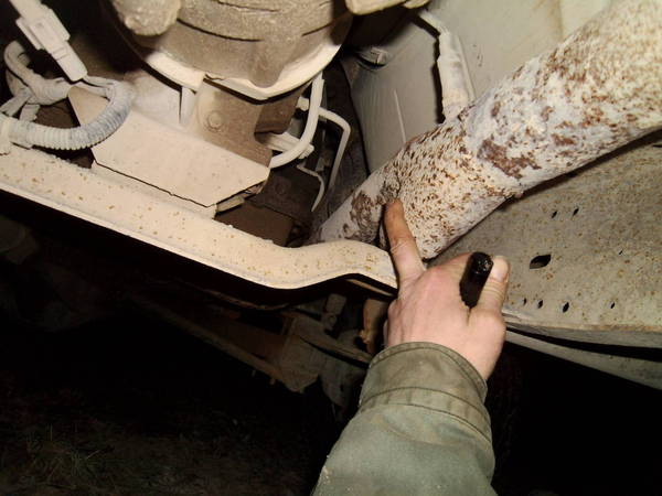

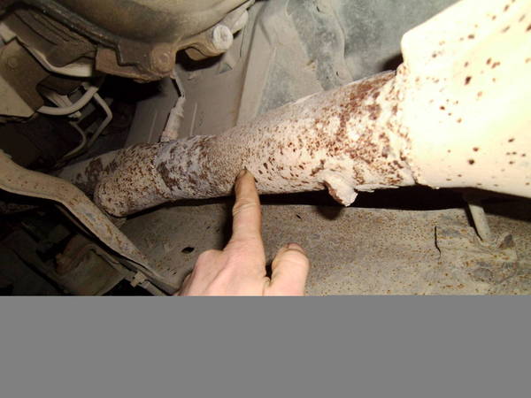

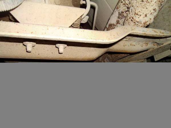

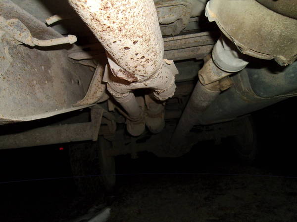

Here are the pics I promised Mike. Sorry for the delay. Things have gotten bat**** crazy here since yesterday morning.
The first two pics are the Hedman y-pipe. The first is the end where they merge with the O2 sensor bung. The second is looking towards the front and the collectors.
In this pic I'm pointing at the extension that Hedman supplies which connects their y-pipe to the factory cat.
This pic is with the camera at trans crossmember level looking back. That is the Hedman extension you see leading into a y that I scavenged which splits back into duals with Flowmaster 10s, the same mufflers 95F350 used. What can I say, I was trying to simulate an X-pipe with stuff I had on hand.
Sorry for the crappy pics, we've had some bad issues come to light with our daughter and I just ran out and snapped some pics in the dark.

Justin thank you for taking the time to take and post the pictures. They are extremely helpful, I gotta see things visually before I understand them. That y-pipe that comes with it extends a lot closer than I thought. Hope all is well!
