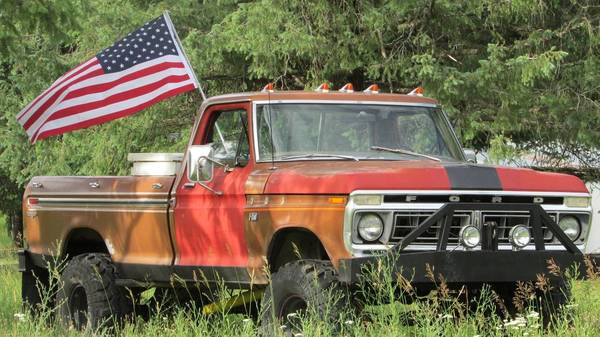

Nice pics Tyler smilieFordlogo
Bet you are looking forward to getting those parts!
Oh I can't wait next weekend ill start swapping out my intake and should hopefully have it done in a day or two.
Thanks I really like the pictures to. Bike looks like a 100 next to that truck though
