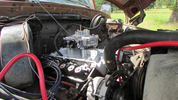

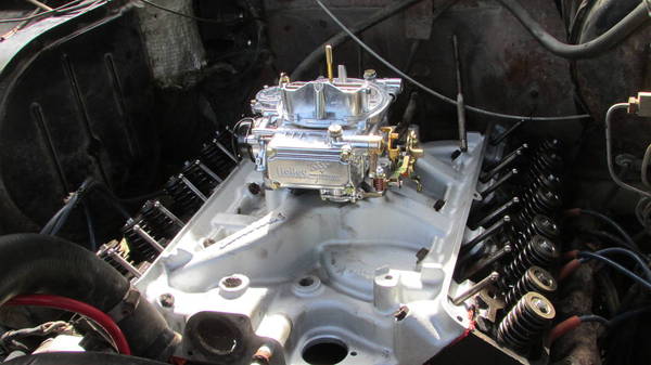

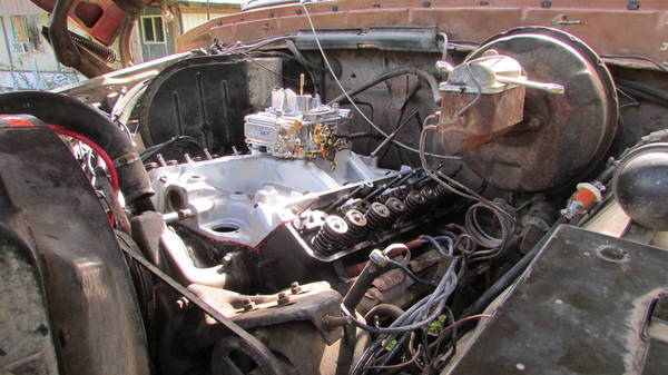

not sure what they are yet haven't looked at the papers that came with it... i got the new intake bolted into place. torqued down and got the pushrods back into place, haven't put rocker arms back in yet...
forgot to do that stupid little piece of hose between the pump and intake so i think i'll just pull off the water pump half an inch to do it. got a few pictures of it..

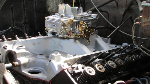

the adjusting screws on top adjust the fuel level in the float bowls. you adjust it be tightening or loosening it while looking through the sight screw hole.
I can't remember...it's been about 25 years since I worked on a Holley.
