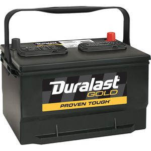

Copied from site:
Gold-Duralast / Battery
6
Part Number: 65-DLG Weight: 44.5 lbs Warranty: 8 YR Notes: 2 required *** 875 cold cranking Amps (1000 cranking Amps) *** . -> 3 year free replacement <-.
BCI Group: 65 Cold Cranking Amperage at 0°F: 850 Jumpstart Protection: Yes Cranking Amps: 1000 Reserve Capacity: 150
Price: $99.99
core:
$12.00
Total:
$111.99

The Golds are the best of the AZ lineup. All our batteries are made by the same company that makes Interstates, but obviously different specs. I have taken those batteries off the shelf and jump started customer vehicles with them...
I guarantee even Interstate has battery failures, had a few that did, and have tested many that did. They don't seem to build them like they used to... I see more of them fail now that I remember from the past.
The one benefit that you would see out of the Optimas for your use is the extended time between operating the truck. They hold up to that better than wet cells do. They do well for someone that has the monster sound systems for that reason as well. They also fail, warranteed a number of them over the time I have worked for AZ...
