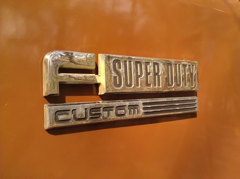

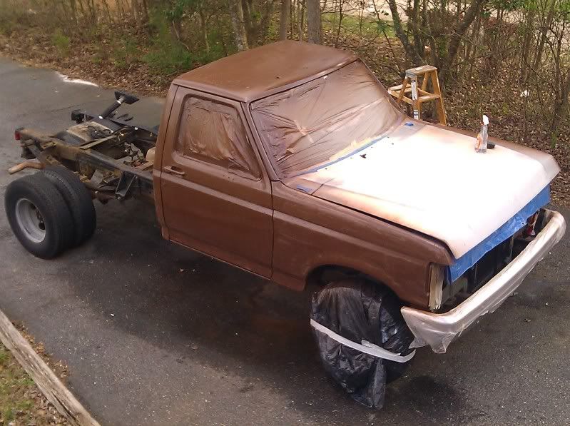

Got a good amount done (finally)! Need about another weekend's work on the cab. Then got to pull the hood and cowl.
A couple of coats on the truck now. Bed is also about done. I guess I should buy a buffer to finish it up, huh?
(Pics are after a sand and I hadn't cleaned it up yet...)

Austin I would let it dry or let the chemicals dry out for a couple of months before color sanding and buffing it out.
That'll give me plenty of time then! :D I had a month in mind, but a couple will do.
Ridgerunner
23,457
573
Stillwater Ok
The paint cure well in that time. If you want to color sand add a couple or 3 extra coats and do 1500 or 2000 grit wet sand.
Don't think I'm going to bother with color sanding. The truck will be a 20-footer.
The better it looks the more $$$$$ at resale time.
