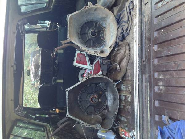

Picked up a couple new toys...
Gonna use the one on the right. Both have been sitting a couple years. The one on the right had 5k on the rebuild...the one on the left was an original 100k trans.

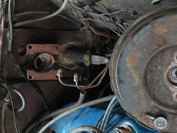

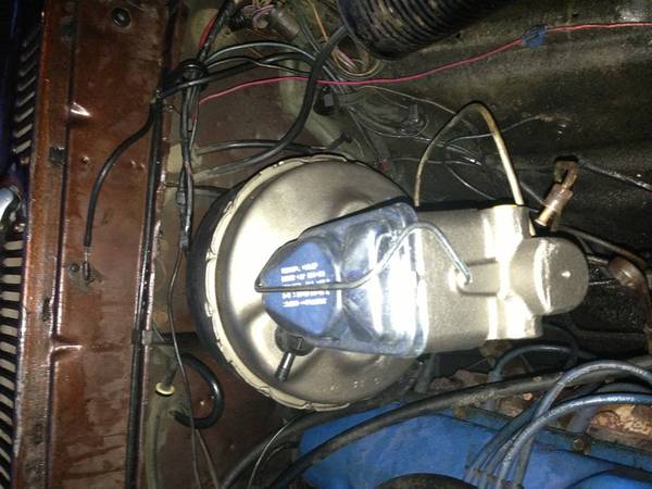

Well boys and girls...the 350 upgrade is complete. Just replaced the booster and mc...tbird calipers are still boxed and in waiting. For the time and money, it's tough to beat. Anything would have been an upgrade over what I had though. The most time consuming part was flaring the tube...I kept splitting it, but Sean let me know I was trying to flare too much. Once I was set straight, it only took about 5 minutes to get a good flares end. Then it was tough getting enough straight tube so the fitting would fit up snug to the flare...so there was another 30 or so minutes straightening tube. The only other hiccup I wasn't planning on was when I went to bleed the brakes, 3 of the 4 bleeders were seized...so I spent about 15 minutes each persuading those out with liquid wrench, a vice grip and a 2lb sledge (overkill I know). So here are a few pics I snapped with my phone...if the rotation is off, I apologize...
What I started with...

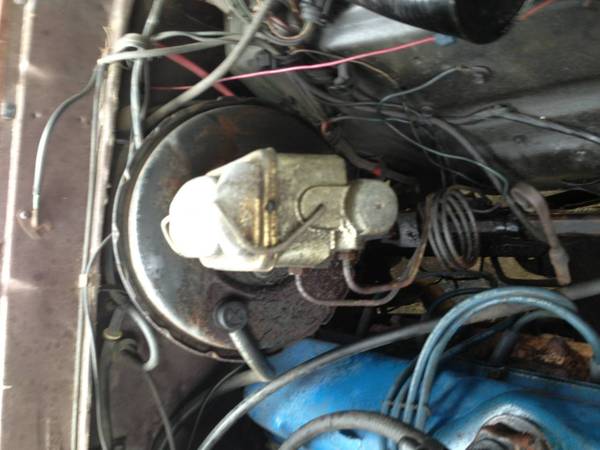

MC off...

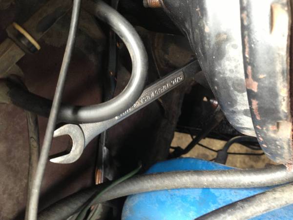

This nut on the backside of the booster is a bugger to get off...but the rest were easy with the hood popped reaching down between the back of the hood and the cowl...made much easier with a ratcheting 9/16" wrench.

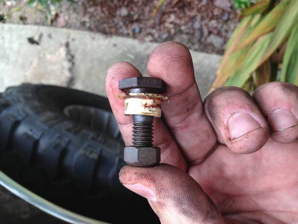

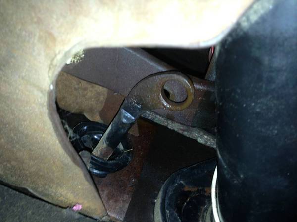

There is a bolt, bushing and nut that holds the booster arm to the brake pedal:

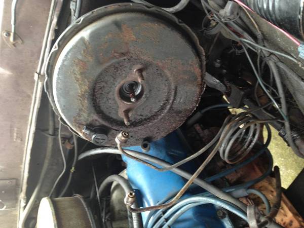

Everything is out...

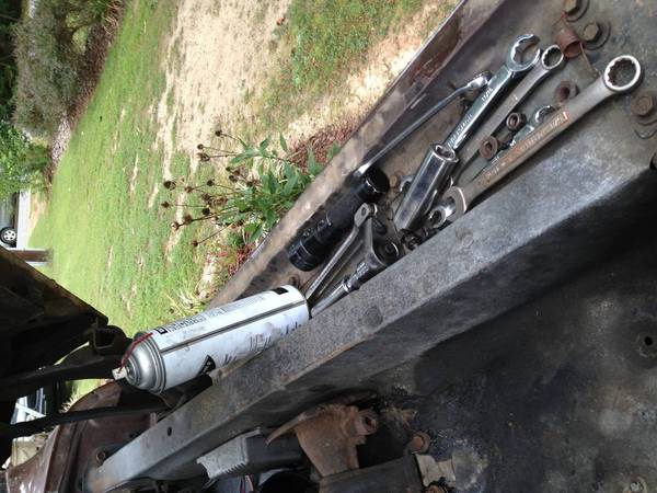

All the tools you need to remove the booster, MC and the bolt on the brake pedal. You'll need a double flaring tool for the rear brake line since it's a different sized fitting. I had a tube working kit to get good straight tube...results might vary. You'll also need a 3/8 brake line wrench for the bleeders...again...results might vary. But the tools you see are all you need for booster/mc removal and install.
The finished product...

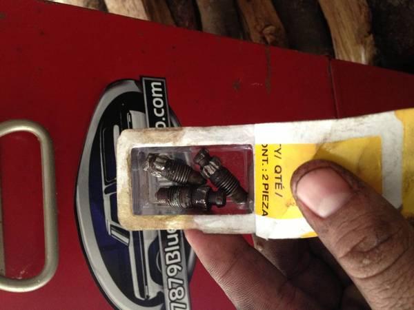

And here is what was left of the bleeders when I took them out...

And this was no nub...definitely a bolt and a nut:
The pedal requires the nub to allow the S/C shut off switch to work.some work by pressure on, others work by pressure off the switch..no bolt for speed control.
