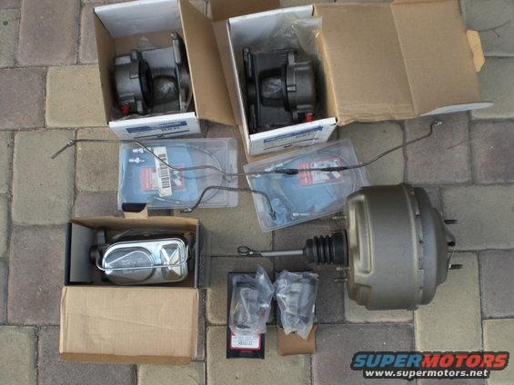

Here are the brake parts going in:

Do a good writeup on the 350 brake stuff, I am going to be doing that to my wifes F250.
Will do...shouldn't be too terrible. Not sure if I'm gonna do it all at once or see how just the booster/mc work...then do calipers and cylinders.
That's a big booster. You don't have cruise?
Yeah...it is pretty big. No cruise in the Bronco or Red...want it, but I'm a few (read alot) of pieces short.
Worth noting about the booster...there are several for 79. Half you can eliminate because you ONLY use the 2wd booster. But there was apparently a change over in mid 79...so serial # DJ0,001 is the cut off. Then as noted...cruise is another factor with the boosters.
