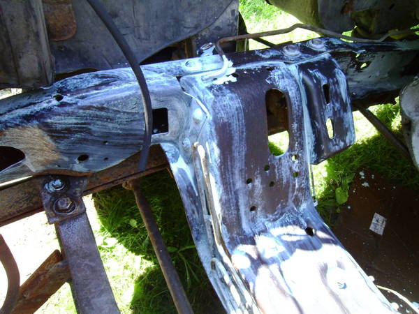

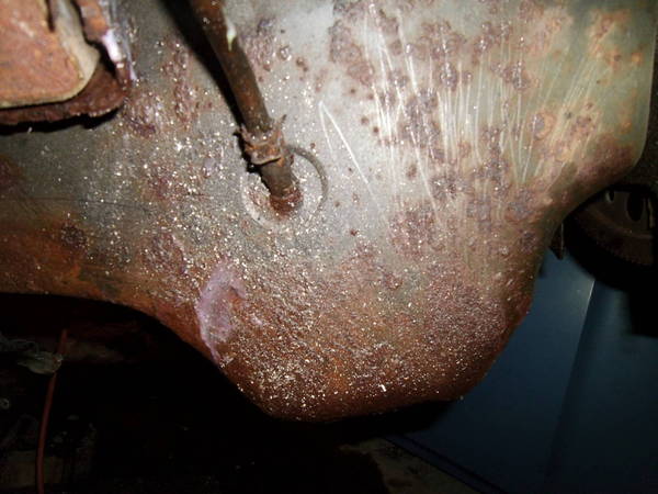

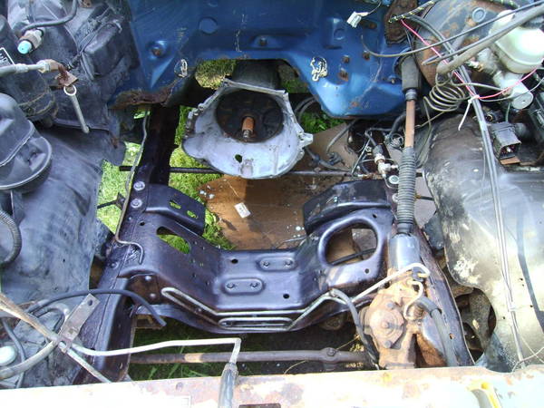

I degreased and wire-wheeled the frame, and then hit it with Rust-Oleum Rust Reformer. I tell you what, that little 8 oz bottle goes along ways. It probably would have gone a little further if I would have been a little more discriminate about putting it on. Here it is when you first put it on.
Here it is after it dries. I`m going to do another coat and then put a gloss coat on it. I would have done more, but I ran out.

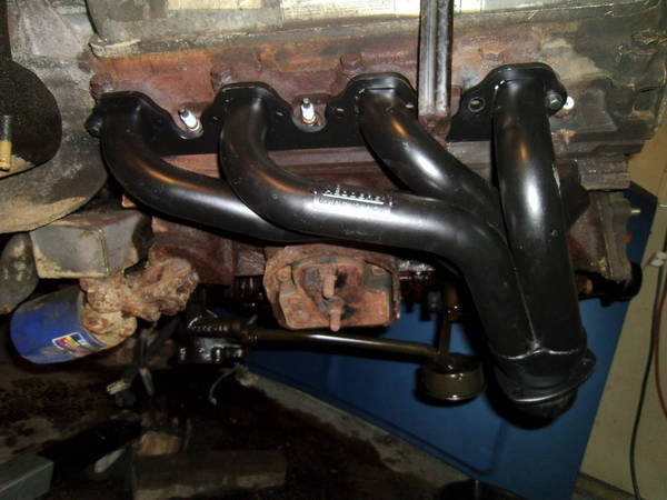

Well, I`ve been waiting on parts. They showed up this week. I ordered a new flexplate from Rock Auto. As much as I like to stay local, they were $104 while Rock Auto was $43. Kind of hard to ignore that kind of difference.

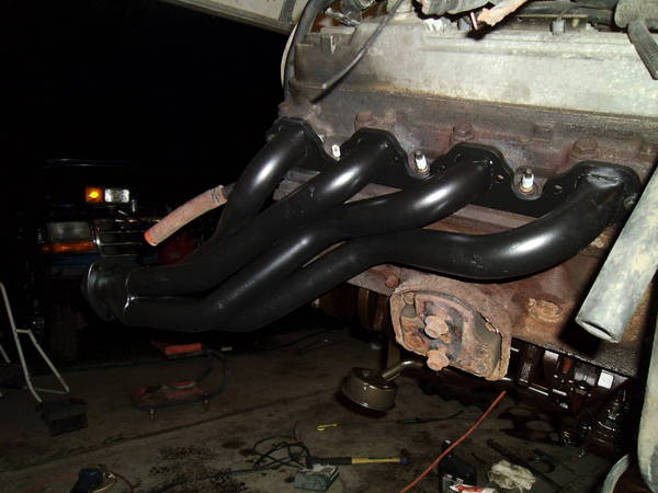

I also ordered a set of headers. I went with some Hedmans from Summit. They came with a y-pipe, and they have ball style connections at the flanges. I don`t think they`re bad units for the price. I would have liked to have gotten the Hedman Elites, but they`re twice the price.

They aren`t actually shorties Roy. The driver side is more a mid length, and the passenger side is a full length.

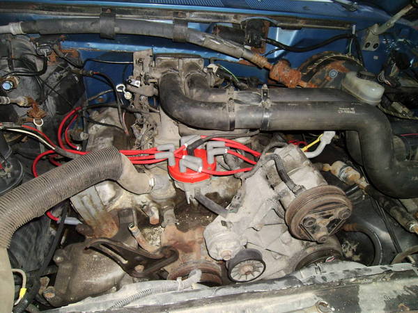

On to some details. The OE oil cooler cleared the frame, but barely. I`m going to loosen the mounts and rotate the engine to get a little more clearance.
The 351 throttle cable and kick down cable swapped over, but I had to use a 460 cruise cable. Of course, when I tried to hook up the shift cable, it was an inch to low. It would appear that at some point in time Ford thought they should change the position of the shift bracket mounting point on the C-6. Probably when they went to cable shift. So I cut my bracket and moved it up an inch. I love my air cut off tool.

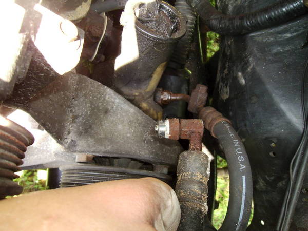

The 351 power steering line worked fine for me, even though it`s different than a 460 line. 460 line in hand.

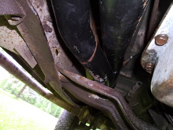

And of course the y-pipe that came with the headers and is supposed to hook into the factory exhaust didn`t clear the brace on the trans crossmember to make it fit.
Like my ghetto dipstick tube?
Kick the tires and light the fires big daddy! It backed into the yard under it`s own power.

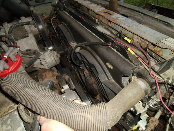

My Windstar fans still fit, but there isn`t an over abundance of room. But there is enough.

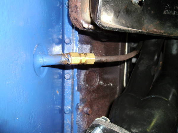

I had a trans line that was leaking, so I replaced that today, in the process I fubared the union, so it still leaks, but I topped off the trans, fired it up and moved it out of it`s spot. I still need to get an alternator, belts, and some heater hoses, and hook up the exhaust, but it`s alive. I also have a stumble when it`s in gear and I step on it. It`s not there in park or neutral.

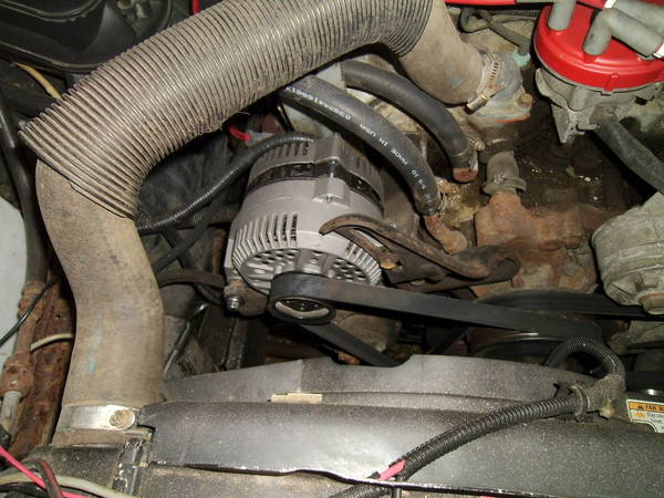

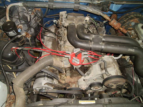

Here is the reman 130 amp alternator I put on. I think it`s for a Windstar, but I`m not sure. I told my guy what mounting I needed, the amps, and he just pulled one off the shelf. He swapped a different regulator on it and sent me on my way. I bypassed the smog pump with a 47" belt.

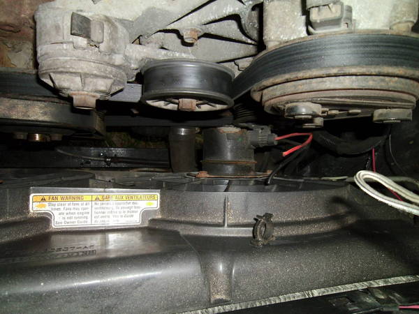

Here`s a couple of pics of the Windstar fans.
Overall engine shot.

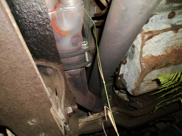

I put together an exhaust using stuff I had laying around. It`s the stuff Hedman sent to hook into the stock cat, which is 3". I split that into dual 2 1/2" with Flowmaster 10 series mufflers and 3" tailpipes that exit behind the tires. I like how it sounds.
