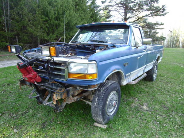

Here`s the truck

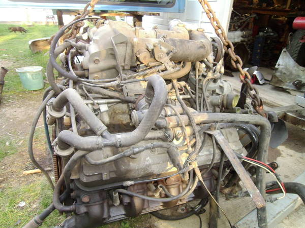

Engine porn

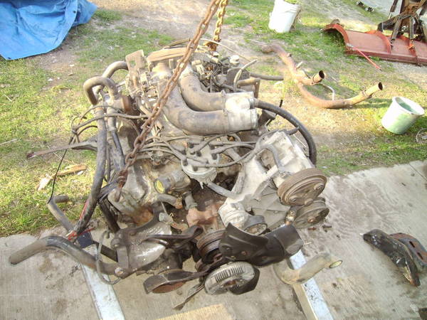

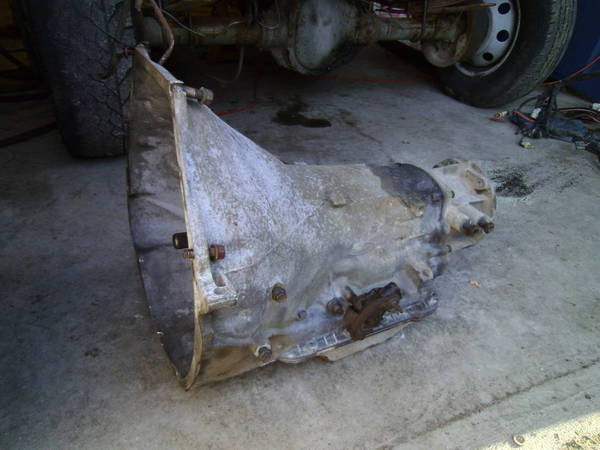

My rebuilt big block trans

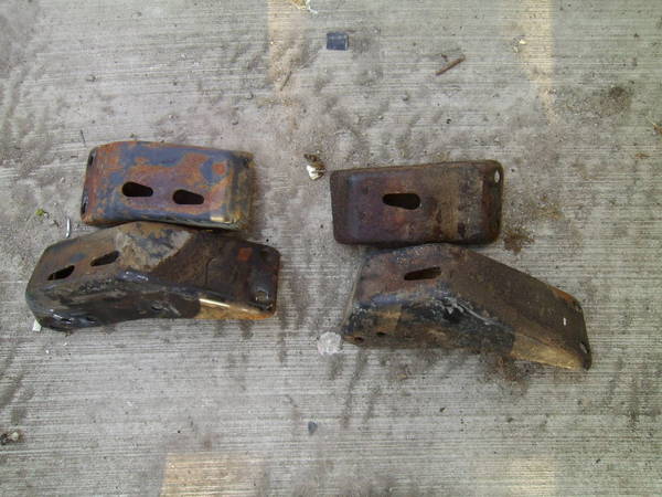

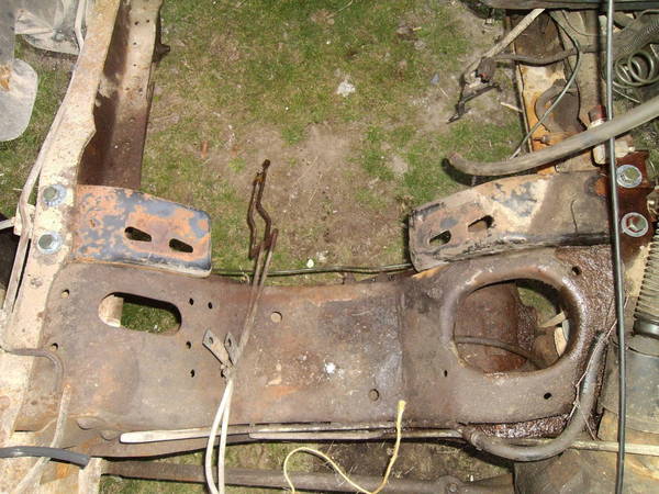

460 frame mounts on the left, 351 on the right.
What they`ll look like installed.

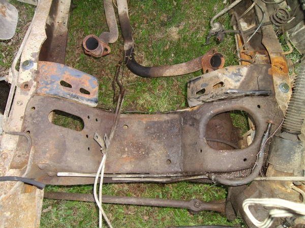

For the record, I wont do another swap this way. All the brake lines became casualties in the process of getting the driver side mount off, and it was a time consuming PIA between taking off the old ones and going to my buddies and cutting the 460 mounts off of one of his junkers. The price was right (12 pack of Killians for the mounts and a 460/c-6 brain), but the last time I did this I used L&L swap mounts and I personaly think that`s the way to go.

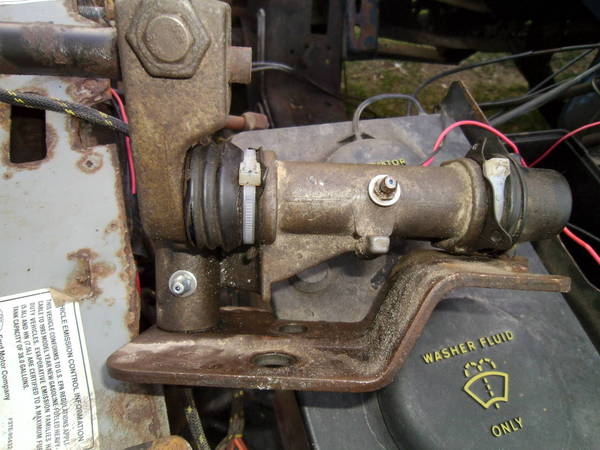

Anyways, I`d hoped to get the mounts bolted up and the manifolds off, but I got bolts that are to long
