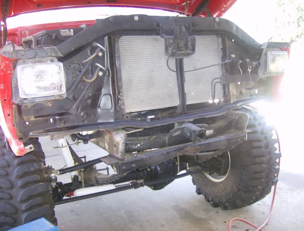

If I may copy someone else......
This is what I want to do
He took a reciever hitch from a late 90's f150 flipped it upside down, cut it to width and welded plates on the end to bolt it to the inside of the frame. Cut out the area behind the lic plate to allow the reciever tube to be accessed.
